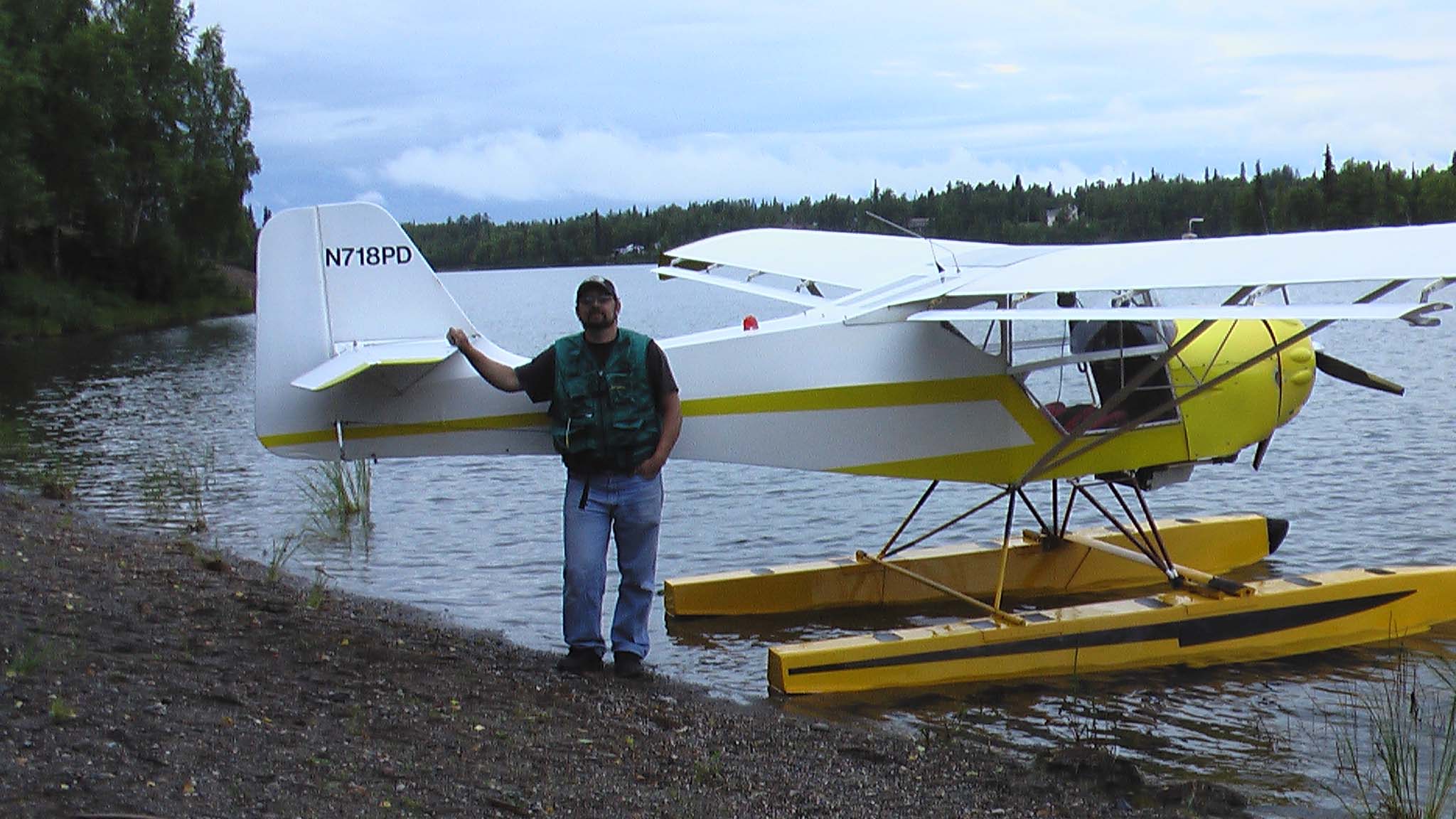

PostPosted: Tue Jul 31, 2007 6:52 am    Post subject: Re: need engineer type to run a calculation Reply with quote
the floats are a scaled down version of the northaires that were made of fiberglass. They are foam filled with no hatches or pump outs.. I am not fond of the foam filling or no pump outs, but they are on my brothers plane not mine! I have a set of the northaire drawings, and will copy them in autocad, then scale them to the dimensions he has. After that it will be easy to find the volume... now I just need time to model them in cad.
I installed the floats on his plane last week and did the test flying. solo it was great, but with 2 200+ guys, a full nose tank and 7 gallns in the wing, it was a bit of a slug to get off the water. she sat a little low for my liking, but most beaver drivers up here will tell you that any float left sticking out of the water is wasted revenue (only partialy kidding here).
