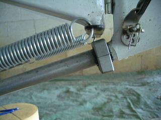

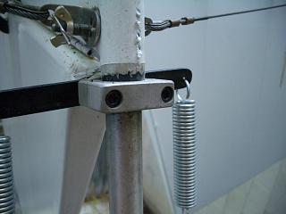

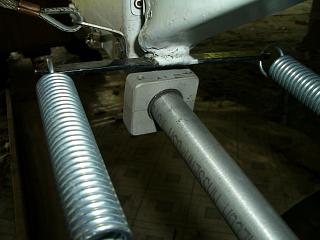

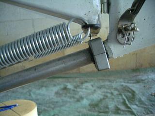

I'm new to the list,so this may be old news to the veteran kolbists.After a few hrs the tail wheel spring begins to loosen in the tail post and allows the wheel to lean slightly.I think I've finally got a good fix.Removed the tail spring, sawed a horizontal cut 1/2 in deep in one side of the end of the tube,re-installed the spring and tail wheel assy,leveled the airplane,leveled the tail wheel then installed a two piece aluminum billet clamp bored to .875 before cutting it in-two, drilled and tapped with 2 counter bored allen head cap screws.Clamp is about 1/2 in thick and 1 1/2 in square.slipped it over the sawed portion of the steel tube and tightened it down .I then redrilled the retaining bolt hole 1 in aft of the original hole and secured it.Also lock tighted the full swivel tail wheel assy to the spring so it will not loosen at that point.Steers smoothly now,and is staying put.JB the carb socket guy machined it for me

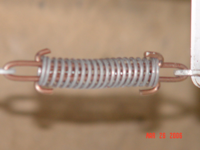

Do you have compression springs ?
Alot of guys have change over to them .
There easy to make....Here's a couple of pictures...
Gotta Fly...
Mike & "Jaz" in MN

PostPosted: Sun Jul 29, 2007 10:55 am    Post subject: tail wheel alignment Reply with quote
gaman(at)att.net
PostPosted: Sun Jul 29, 2007 11:08 am    Post subject: tail wheel alignment Reply with quote
Mike,
I'm familiar with the mod you picture,but I have replaced the original springs with stiffer ones from Ace hardware.because of the taxi problem in stiff crosswinds.This mod just evens out the rudder pressures and takes the jerky response out of it
thanks,G Aman

PostPosted: Mon Jul 30, 2007 12:13 am    Post subject: Re: tail wheel alignment Reply with quote
Mike,
Where is your source for the compression springs? Looks like a good way to go.

gaman(at)att.net
PostPosted: Mon Jul 30, 2007 11:21 am    Post subject: tail wheel alignment Reply with quote
I hope my picture sending skills are better than my descriptions.
Thanks G.Aman
