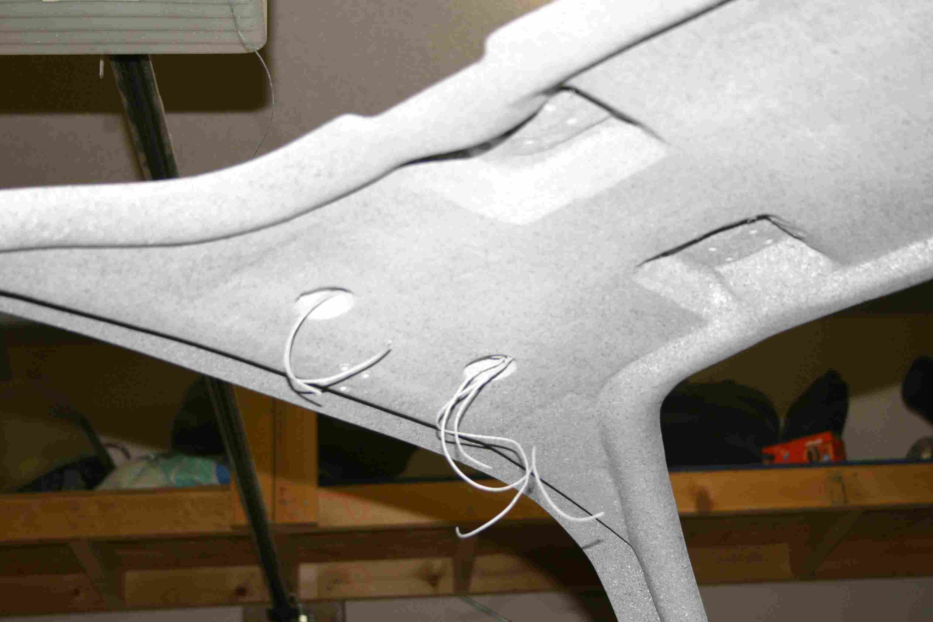

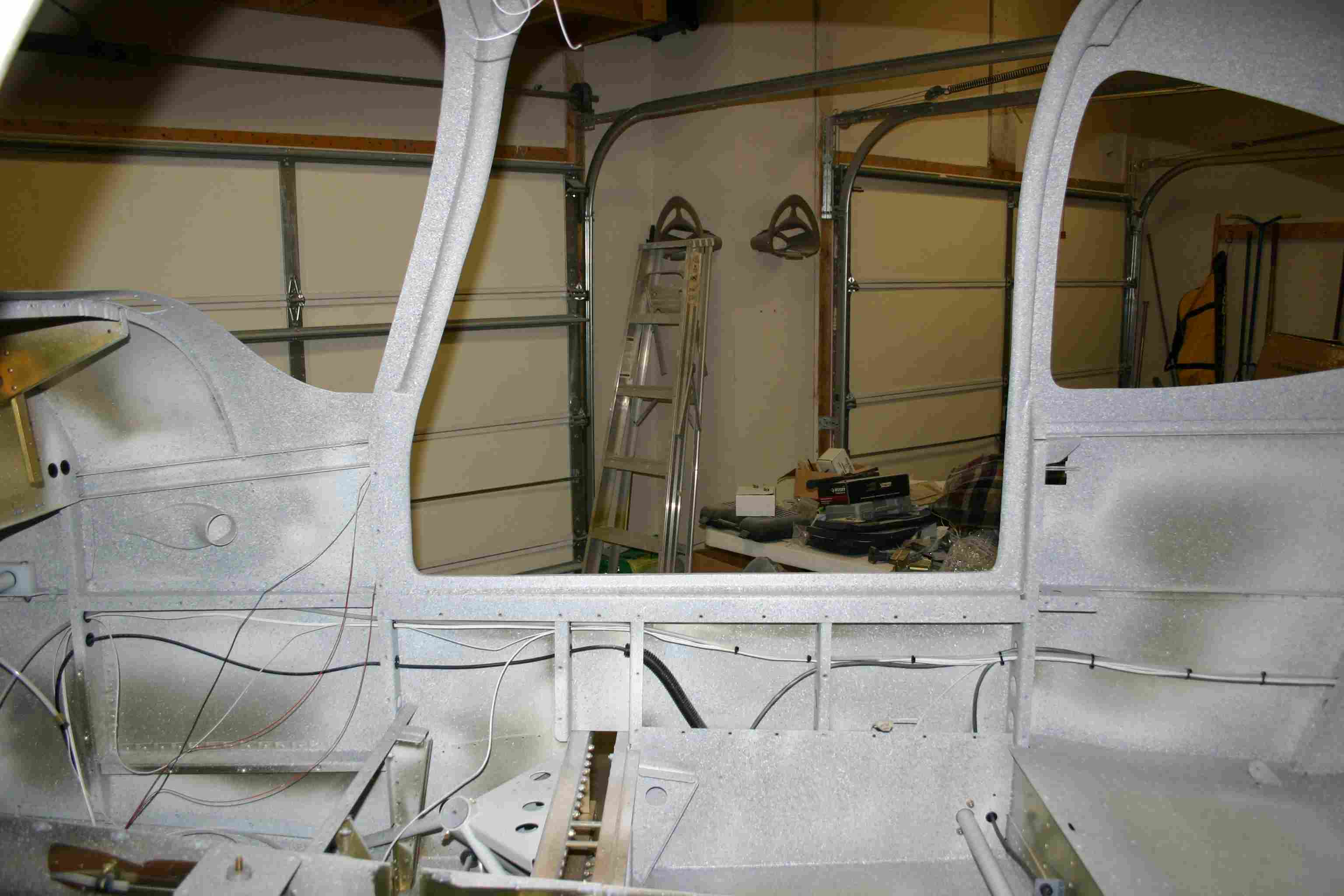

PostPosted: Mon Feb 13, 2006 1:15 pm    Post subject: Overhead Lights Reply with quote
            They aren’t the greatest but they are all I had with me at work.  You can see the three wires coming out of the bottom by the front pillar on the passenger side.  The wires run up on the inside to the center of the canopy and then I drilled a tiny hole for then to run into the foam which is in the top lid and then they come out the 1 ˝” holes I drilled on the inside top.  I removed about ˝” of the foam and then glassed in the bottom again.  This will allow the swivel eyeball to move freely.

PostPosted: Mon Feb 13, 2006 1:17 pm    Post subject: Overhead Lights Reply with quote
I plan on creating a hard backing that my material will glue to
and the lights will mount to it. This is going to cover the top over
the pilot and copilot side to cover the bolts for the doors and run aft
to where the roof height increase 1".
