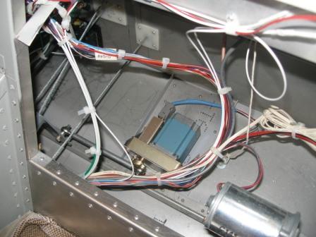

I have a 601 HDS that I am going to put a autopilot in. Searched the forums but could not find any photo's anywhere that might show how others have mounted the servo. If anyone has any photo's or info on how they did it I would appreciate the info. Thanks, Jack

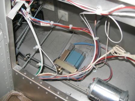

Jack,
I am building a 601XL. I am not familiar enough with the HD to know what differences there might be in this area. The attached photo is of the area behind the pilot's seat. The servo is in the center. The gizmo in the lower right is the flap actuator motor. The servo is part of the TruTrack ADI Pilot I single axis autopilot system. The servo is attached to na .050" 6061- T6 "strengthening tray," which is bolted to the floor skin. The servo actuator rod is attached to the aileron control horn on the end of the torque tube. The aileron control cables will later be attached to this same horn. Questions?
