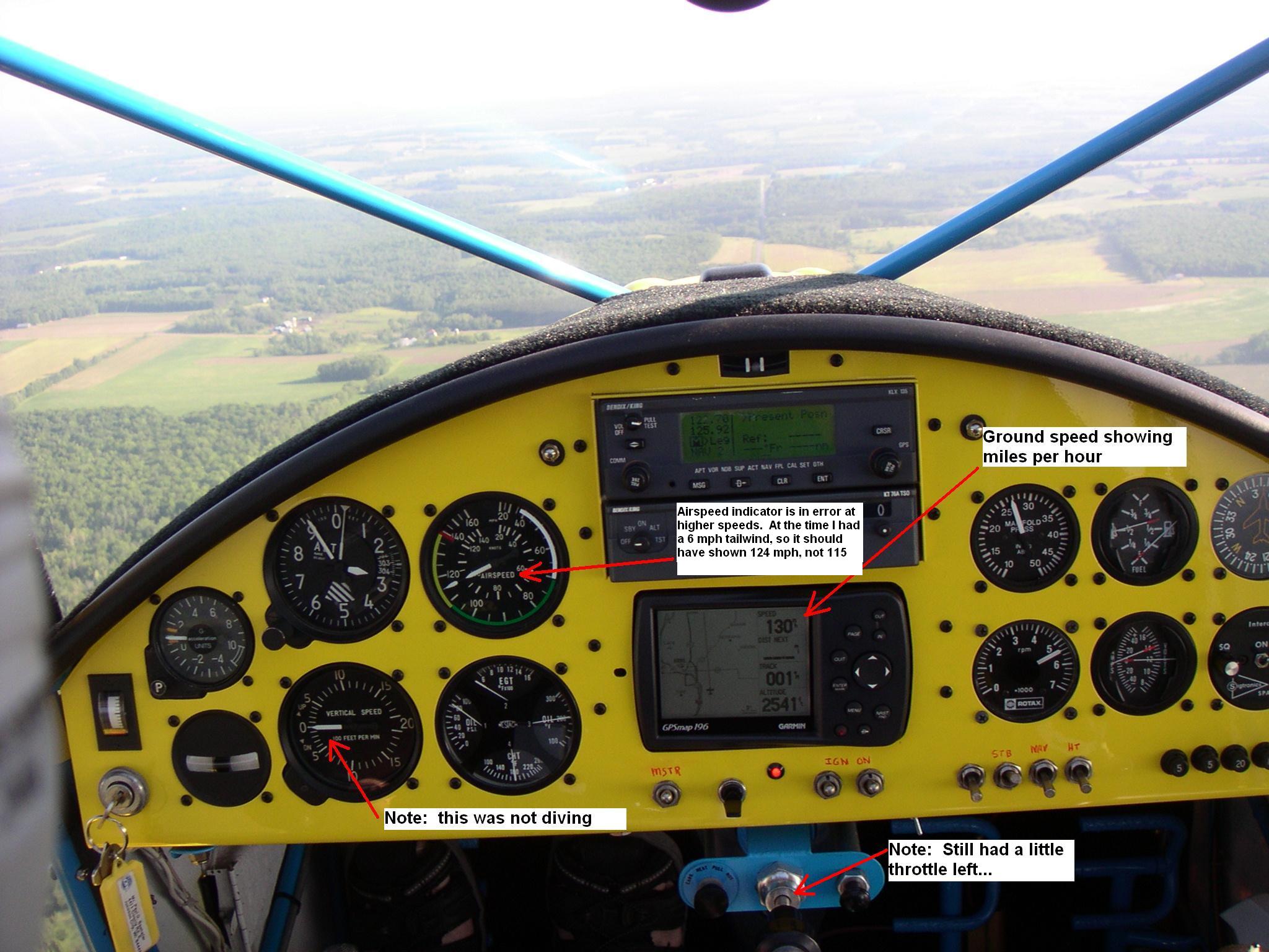

Giovanni,
I've found with my Kitfox IV-1200 912ul on amphib floats (with an IVO
inflight adust prop) that it goes the fastest with the throttle wide open
and the prop set for a 5400-5500 rpm, which is the max continuous horsepower
for the 912 (all 79 hp!)
Yes, get some of those fairings on your airplane, as I fly 90 mph+ at 5000
rpm, and I'm on floats with long wings!
I've attached a panel shot to inspire you. If my long wing kitfox on floats
can fly this fast on floats, your speedster should definitely go faster...

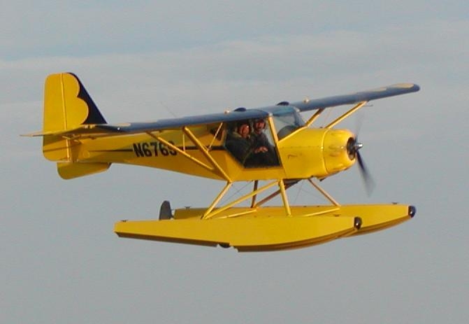

And here's a pic of my plane in flight. It's a neat little Kitfox, but it
can be cleaned up significantly yet. I have wing strut and horizontal
stabilizer strut fairings, but nothing on the jury struts, no gap seals,
poor fit around vertical fin to stab fairing, and no radiator fairing. Once
I do all that I expect I will go faster yet!

What a great looking fox, now I want to go and find a new set of floats to
go on mine...
