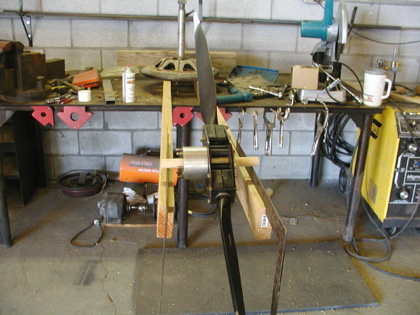

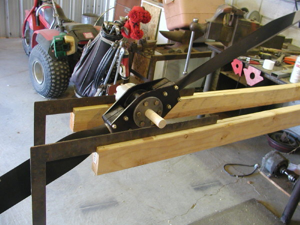

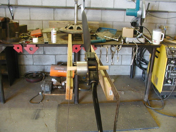

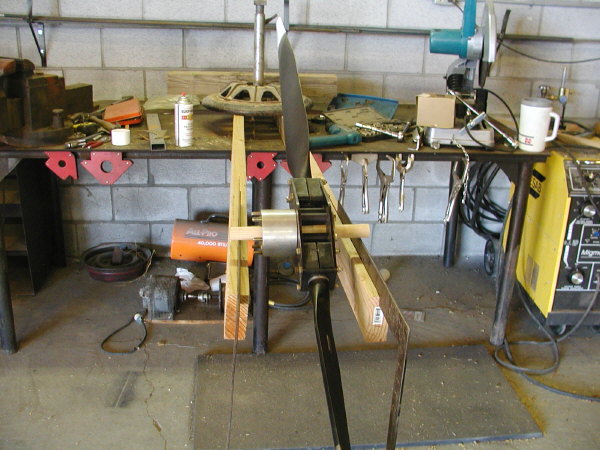

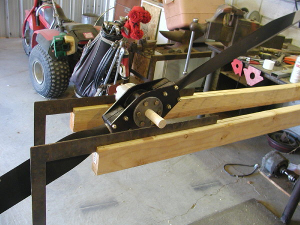

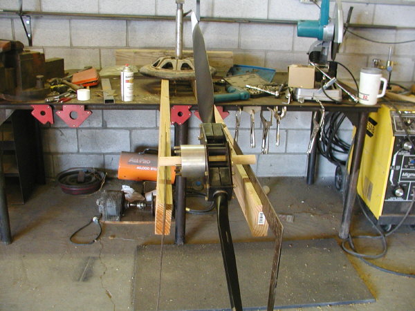

I am trying to get Possum's video camera to the point that I can use it, but vibration is killing me. Due to the enclosure I have to hard mount it to the frame up by the nose cone. I have it as solid as I can and braced as well. Even with the camera stabilization there is noticeable vibration. John H and John W helped me set my blade angle when they were here, but I painted the tip to get it ready for its Air worthy inspection. I suspected that I got a bit more paint on one tip than the other, so I rigged up this set up to balance it. Spraying paint on what appeared to be the lightest tip until it balanced out. Every thing was level as well. If my methods are correct then the vibration (still more there than I would like) is not going to go away. Blades were rechecked and are still right on for angle. The blades were set in varying positions and did not move from setting.

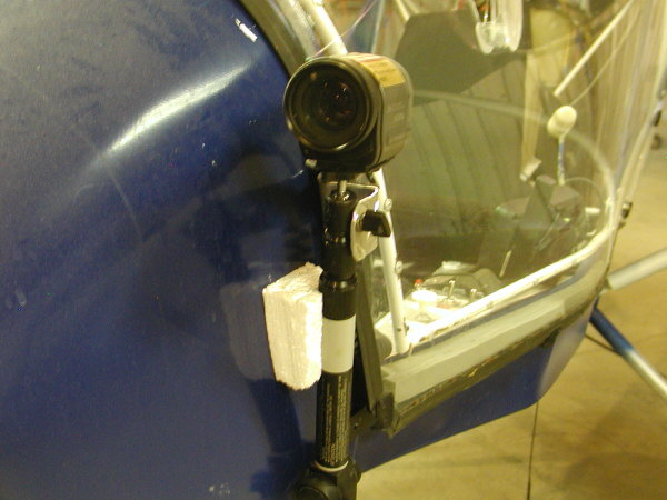

Thanks for the tip Mr Pike, but I don't have a hoop. Here is how I have it mounted on the plane. I think that without having it shock mounted I am going to get this vibration. Perhaps a three blade would be smoother, but I guess I will never know.

I've had very good vibration free video by mounting the camera on a wing strut with 1" thick (before compression) foam rubber separating the mount and the strut. There are countless ways of doing the mounting but making the mount shock absorbing is the key.

I have tried putting a bit of stiff foam under the camera, wind has been blowing too hard to make it fun, so I am biding my time waiting for a bit of calm. I have a Sony High 8 camera, so I had a lot of batterys that fit the camera. Most of them will last the Sony for as much as four hours. Man that thing eats batteries like candy. I had hoped that I would be able to smooth the plane out with balancing the prop. It is balanced but there is still enough vibration that it over powers the stabilization feature. I stuck the camera to the side of my headset, and got a great view of the hinge in the windscreen and the heater tube. I am a bit afraid that the duct tape would pull out my whiskers when I took it off. Smile Not only that, I find that I am a good pilot in that my head any eyes are scanning all over the place and I get a bit seasick when trying to watch the video.

I had a friend that was going to build a model helo blade balancer….. it was to consist of an accelerometer and a processor that would take all the guess work out of balancing the prop…. I found when balancing a helo blade…. You could static balance it like you did in the photo…. But when it was spinning up to speed it still needed some fine tuning… I used a wrap of electrical tape at the mid blade ( the cg of the blade) and tried it to see if it was worse or better…. Then adjusted it from there… either more or less tape on that blade or the other…. I will try and see if my friend built something he could market or sell me and find out how much $$$
