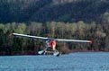

I have a single port at what is almost the widest part of the plane (just in front of the door) I have considered putting a second port opposite the existing one to balance the static port in a slip.
Only problem with my location is I have to disconnect it every time I want to remove the lower main cowl. ( model III-A)
