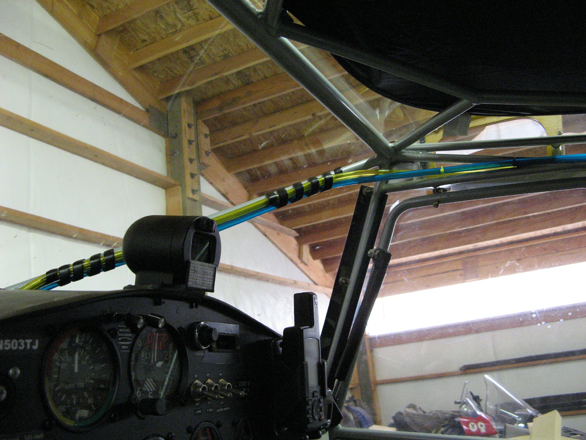

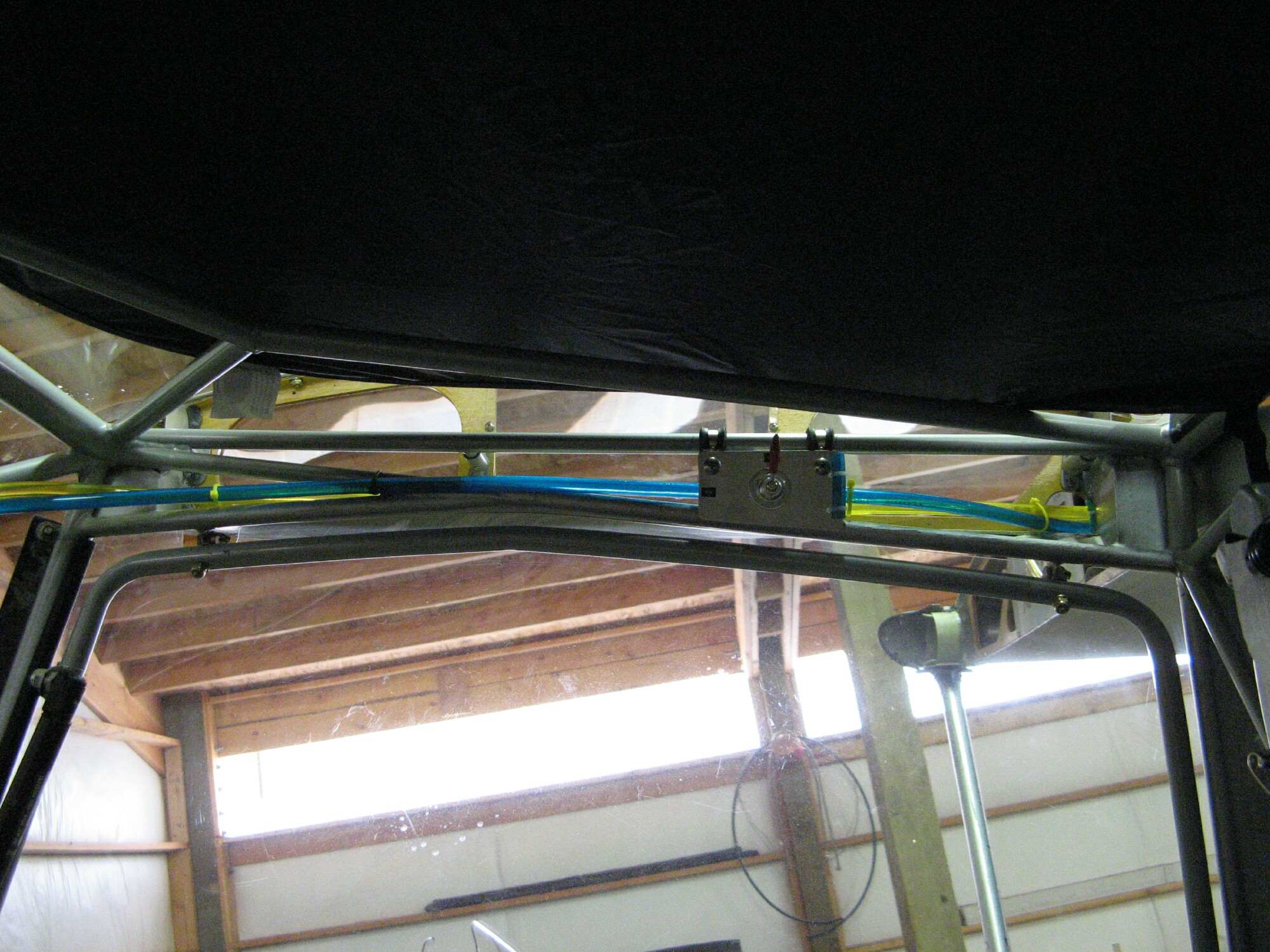

My fuel transfer is too slow to suit me also, and the wing tank flow stops easily, especially when the fuel is low. The transfer flow varies from about 8 to 13 gallons per hour.
I have a right wing tank that transfers to the panel tank. The fuel line is 1/4 in. ID urathane. The line runs from the wing tank forward above the door and down the diagonal fuselage tube to the panel tank. There is a shut off valve and an in line filter in the line. The panel tank vent line runs to the top of the wing tank.
I think the in line filter is restricting the flow some but believe the biggest cause of the problem is not enough down slope in the line from the tank to where it starts down the diagonal tube.
The kitfox fuel systems that I know of that worked well all ran the fuel line from the wing tank imediately down behind the seat, forward under the seat and door then back up to the panel tank. I have not gone with that route because I don't like the idea of that significant low spot in the line that could collect water and maybe even freeze.
I keep looking for some 5/16 ID urathane fuel line to try but no luck so far. There is plenty of 5/16 rubber fuel line on the market but I am using premix oil in the fuel and have heard that the oil will deterioriate the
even freeze.
rubber fueline.
