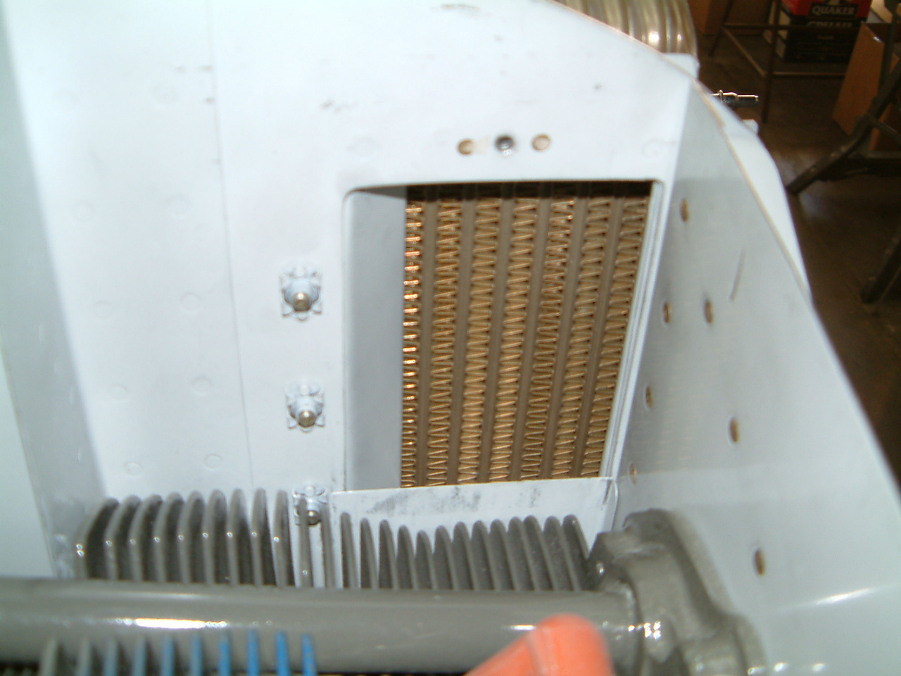

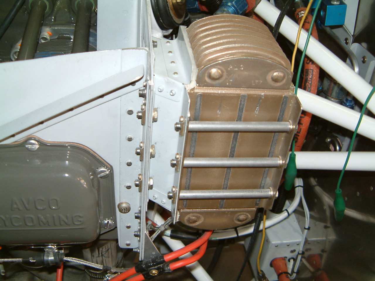

Hi Dean,
I am not an engineer so I will avoid the comparative structural strengths of
nutplates verses Nylok fasteners etc.
My oil cooler is mounted in the position that you intend to use. I used
floating nutplates similar in strength to what you describe.
Based on others descriptions of successes and failures you should consider
adding some strength to the baffles in the area around the oil cooler
mounting position.
I have seen pieces of aluminium angle being used as braces running from one
of the engine case half bolts back to the oil cooler to add stiffness to
that corner of the baffles.
I chose to add doublers to the baffle parts in that general area. They show
up in the first attached photo.
I used all six bolts for the added strength to hold the oil cooler in place.
I have low hours on my 6-A to date but I doubt that the nutplates will be a
failure point in the foreseeable future. I will be watching for cracks in
the baffles but I don't expect to see any very soon.
Since the attached pictures where taken I added a filler piece to the top of
the baffles so that the baffle seal material runs straight across the top of
the rear baffle with out the usual joggle just above the oil cooler, (much
neater and easier). This addition also added a little more rigidity to the
area.
I will wait to see one of the engineer types supply the strength data you
request.
Keep building, it's not far now,
Jim in Kelowna, RV6-A C-GIIG 30 hr. since first flight
