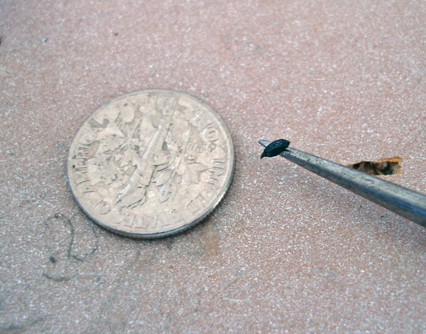

Every month I get a call or two about float bowls overflowing and engines running too rich from too much fuel in the carb bowl. Most of the time the cause is a small piece of rubber debris that hides inside the rubber fuel hose after it is cut to length. Only at some future time does it work its way down to the float valve. We have also found small pieces of dirt that found their way into the line after it was dropped on a dirty shop floor.
John Jenkins was kind enough to send photos of the debris he found. The email he sent and my response follow below:

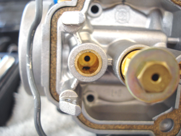

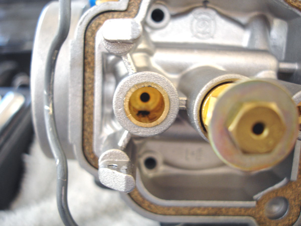

John’s return email with photos:
Pete, you hit it on the head. At first I found nothing. Then I put some hose on the fuel inlet and blew lightly. Clogged. Blew harder and you can see what appeared in the valve seat. I'm including another photo to show the size of the shard.
I hope I've learned my lesson. Thanks for the help. jj
Jabiru USA would always suggest blowing out the fuel hose after cutting and after hooking up the fuel system to flush a quart of fuel through the system before starting the engine.
Pete
