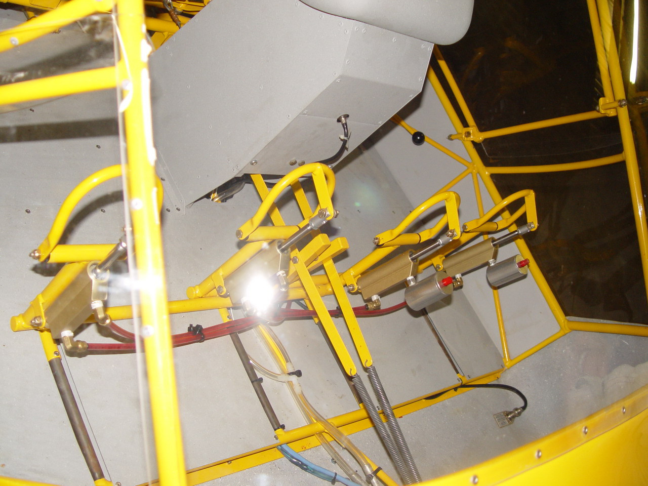

PostPosted: Sat Jun 30, 2007 6:48 pm    Post subject: Dual controls Reply with quote

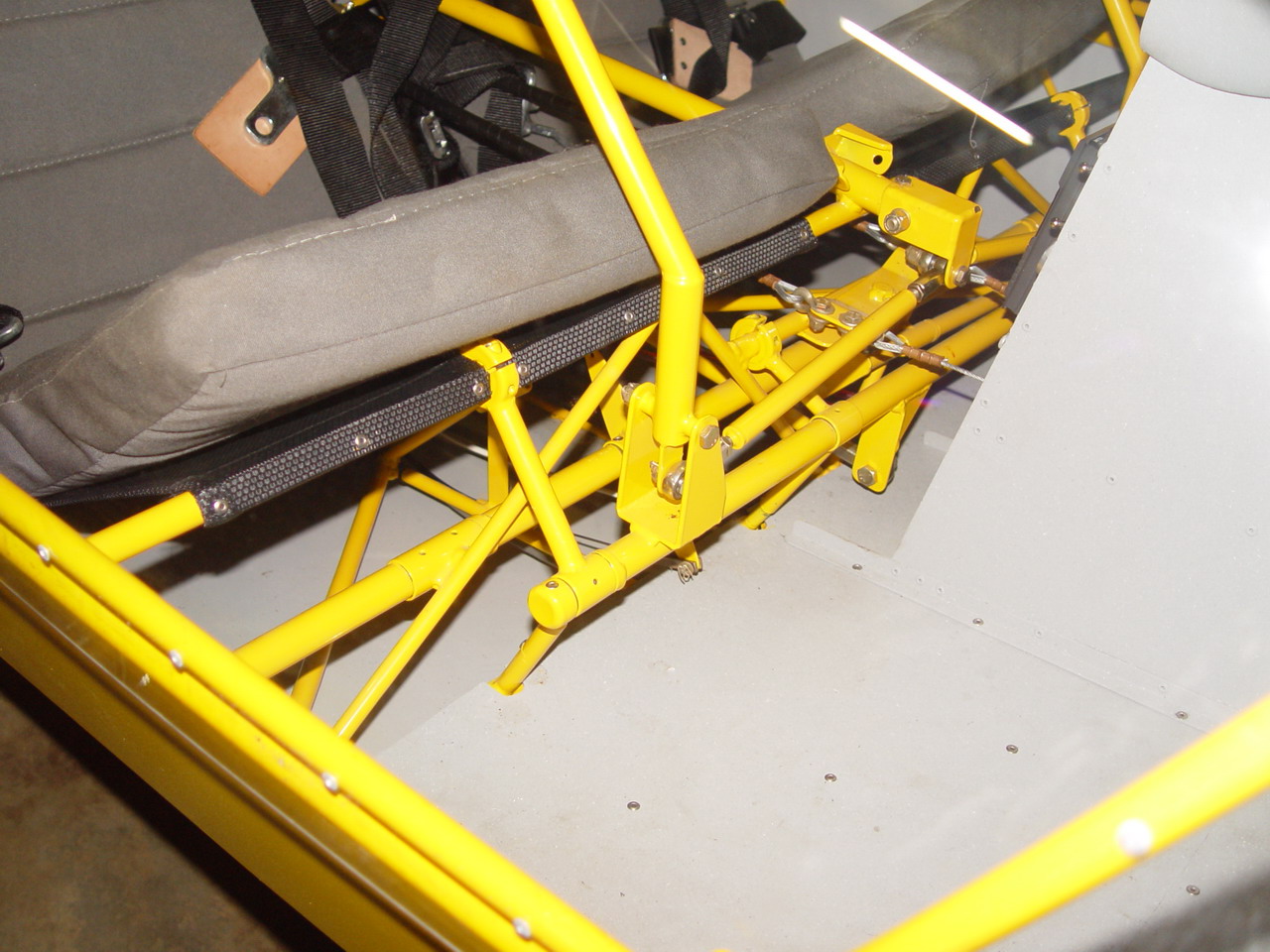

Heres one.
 Filesize:  337.29 KB
 Viewed:  619 Time(s)

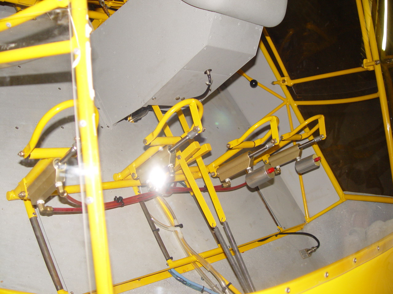

PostPosted: Sun Jul 01, 2007 7:31 pm    Post subject: Re: Dual controls Reply with quote

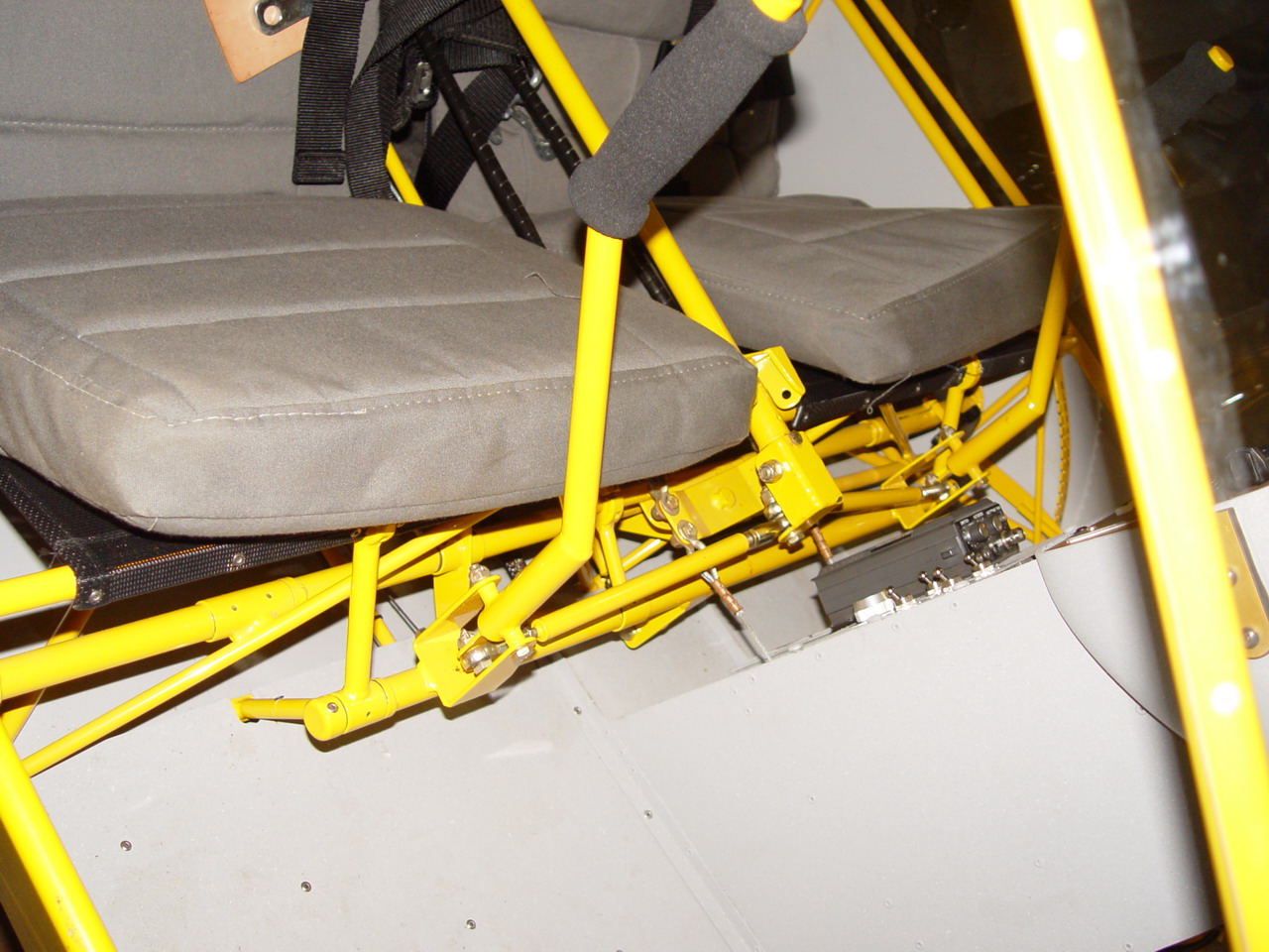

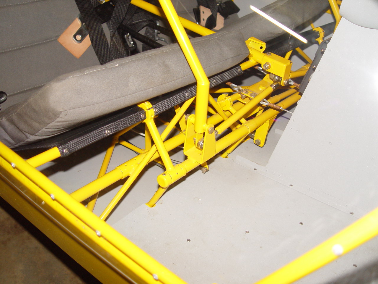

I would have to also suggest that you buy the dual controls from TNK. They work perfectly, and will save you a lot of work that has already been done by others. Aside from the obvious advantages of dual sticks in training, if the stick breaks off in your hand while you are flying, you can just reach over and fly with the other stick Laughing
Given the amount of time it will take you to develop and scratch build these dual controls, you will be better off to work some overtime and buy the dual controls from Kolb and bolt them on.
Here are some pictures of mine, maybe after seeing this you will like the factory ones so much that you might just buy them.
Mike
 Filesize:  281.69 KB
 Viewed:  618 Time(s)
 Filesize:  282.64 KB
 Viewed:  590 Time(s)
 Filesize:  294.84 KB
 Viewed:  616 Time(s)
