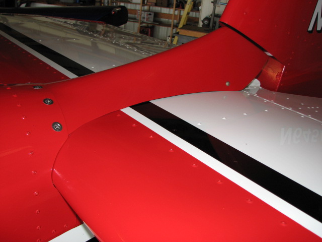

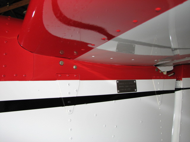

agbeyer(at)sbcglobal.net
PostPosted: Sun Jul 01, 2007 11:47 am    Post subject: Mounting horizontal stab and fairings Reply with quote
Dred,
Here are a couple of pics of my HDS.
Al from Oshkosh

dredmoody(at)cox.net
PostPosted: Sun Jul 01, 2007 2:57 pm    Post subject: Mounting horizontal stab and fairings Reply with quote
Thanks to all who have sent photos and drawings and offered help. I think I have a handle on what I want to do and how to do it now.
Dred
