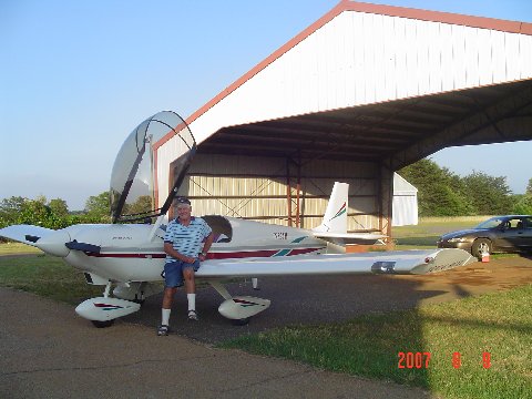

Yup Craig I'm glad you are amused. I am amused every time I see some poor builder out there waiting for their parts that they paid for over 9 months ago while William is out on vacation. You must be one of those guys that would follow someone off a cliff. The good news is that I did make molds and jigs off Williams parts and I won't have to wait 9 months for him to quit talking about himself and make my parts I will make them myself and finish my project on my schedule not Williams.
As far as the other list I have no desire to be on it. I found it quit amusing that I got kicked off but from what I understand it isn't a corvair list it is a WW list. I own several big web sites and if I wanted to be on that list I would be on it.
I have finished and flown my first 601 XL with a corvair and I am building 2 more. I found several flaws in Williams way of doing things but of course I am not William so anything I would want to contribute would be pointless. And no Craig that isn't me in the pic.
