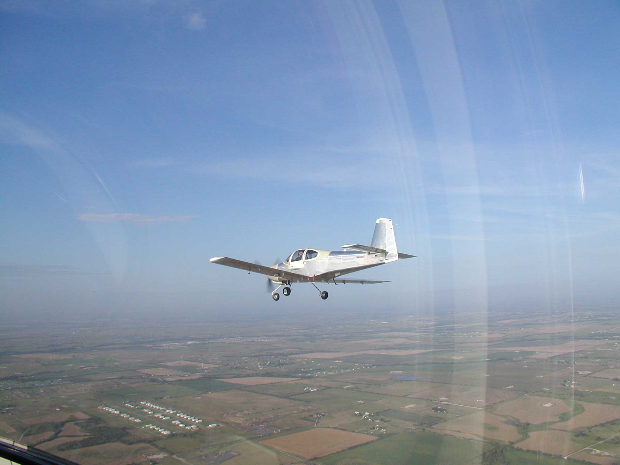

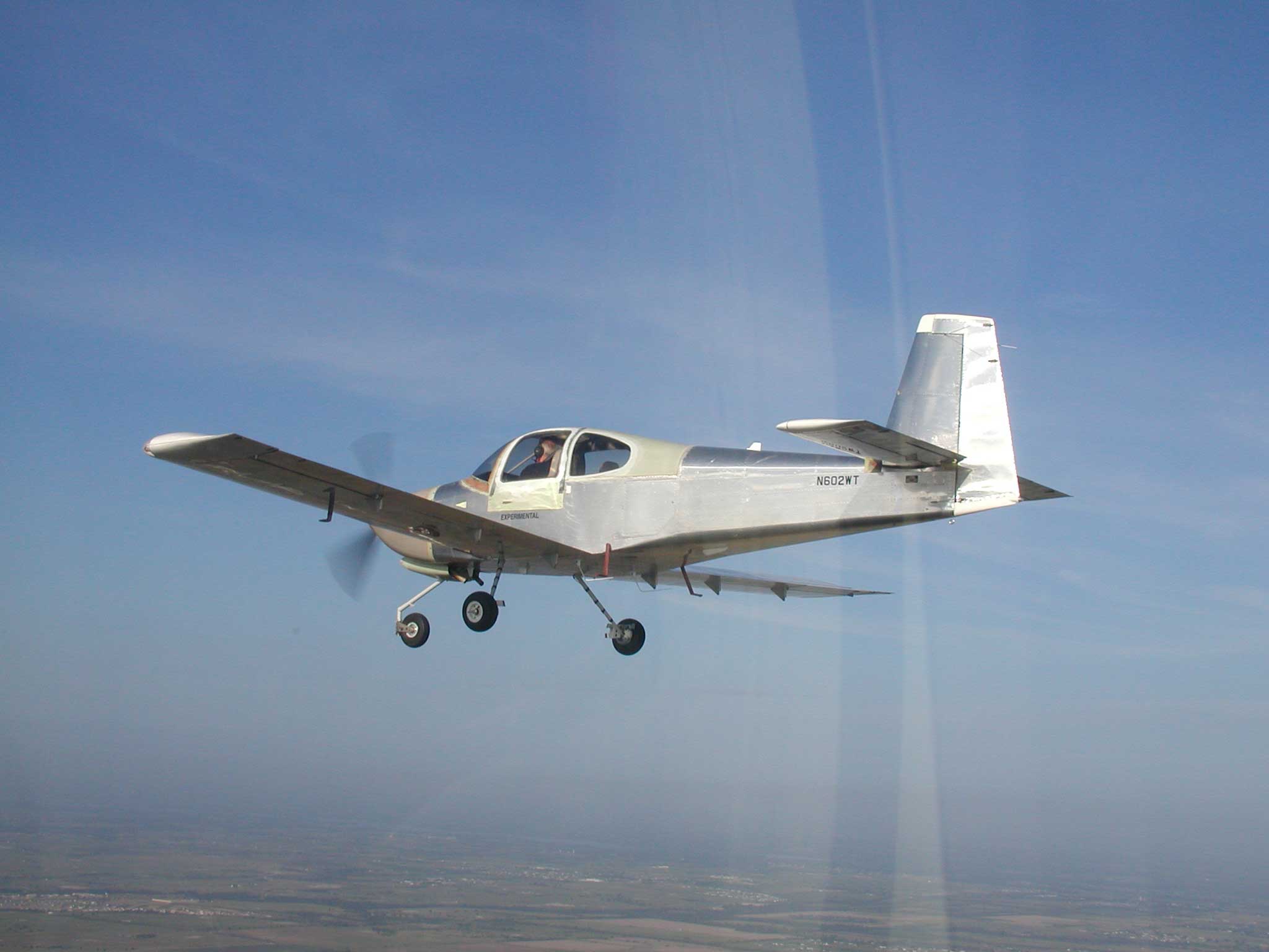

Well, fellow builders, Saturday 6/23, at 8AM N602WT made it’s maiden flight. After all this time building the feeling I got when it left old Terra Firma was great. It wasn’t the flying as much as the idea that “Hey, I remember when this baby was in a box in pieces" feeling.
I had been trying for a couple of weeks to take it up but the weather here in north Texas has been damp to say the least and between my hangar and the runway was a lot of soggy grass. Also because my family wanted to be there I had to wait for the weekends.
Anyway, we had a perfect day to fly yesterday and it flew beautifully. It was really a great feeling shooting down the runway with it wanting to get off the ground very quickly. I had put two 50lb sand bags in the rear to move the cg a little bit aft. Once I was in the air, and started breathing again :>}, I was really happy with the control response I was receiving. I made a race track pattern around the airfield and on about my third downwind I let go of the controls and flew the total length hands free. To be honest with all the jockeying around with the aileron and elevator alignment we had to do during the build I thought for sure I would have some type of trim issue, but happily for me I didn’t.
I had flown transition training with Alex DeDominicis in his 11, but somehow flying in your own plane gives you a completely different feeling or at least it was for me.
A good friend of mine on my airfield, Ron Grover and his wife Barb, flew chase plane with me in his RV8. Ron is also building a RV10. I think his build number is 60 or close to that. He’s close to taking flight soon also. Anyway with Ron in the air with me we could compare airspeed readings to be sure that my airspeed was reading out correctly and that I didn’t have anything leaking out the bottom. Barb was the official camera lady and took some great photos. I’ve attached a few they sent me last night. In first flight 1 photo if you look down and forward of the plane that is our airport Propwash 16X, which is just north of Fort Worth.
We had decided that we would stay up for about 30 minutes in this first flight and we were getting near that time so I decided it was time to stall test the plane before I landed it the first time, so I did and it stalled clean at about 61kts, which is what I think everyone else was finding. After the stall I leveled back out with applying power and the engine did a small hiccup of sort. At that point it seemed like a big hiccup to me. I reduced power and switched tanks and noticed that I had no indicated RPM, even though I knew I did. So it didn’t take much thought to decide it was time to get back down to the runway.
I did the downwind at 90kt and the final approach at 80kts and was able to land it without embarrassing myself too much. Once back to the hangar we removed the top cowling to inspect for leaks and there were none.
I obviously have to get onto why I’m not getting any RPM reading. A first guess is that one of the wire couplers came loose and also, when it did that, it caused my Lasar electronic ignition system to go offline and switch back to the standard mags. I’m guessing that’s when I felt the engine hiccup momentarily. I have a light to tell me if the Lasar goes offline but it wasn’t on so we’ll just have to dig around a little.
Anyway, sorry for the long rant but if I had to summarize for you how the plane felt in flight I would have you use the word "smooth". My son and son-in-law videoed the flight and I will post it when they get it to me.
Now I’ve got to get the hiccups fixed and get the time flown off.
Boy I have to say I have so many people on my field and others to thank for all the help they've all given me in getting to this point. I know without all their help I wouldn't be ready to fly yet, that's for sure. Muchas gracias to all of them.
Wayne Edgerton #40336
Now amongst the flying. Paint date scheduled for September

last night. In *first flight 1* photo if you look down and forward of
Worth.
some great photos. I've attached a few they sent me last night. In first
