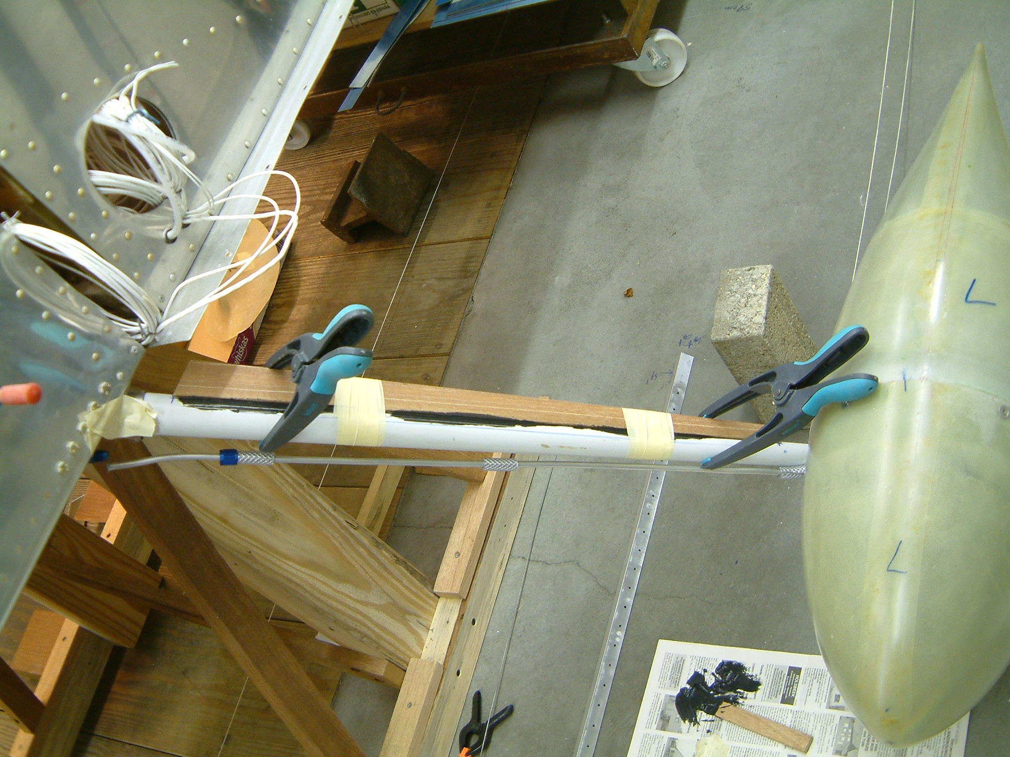

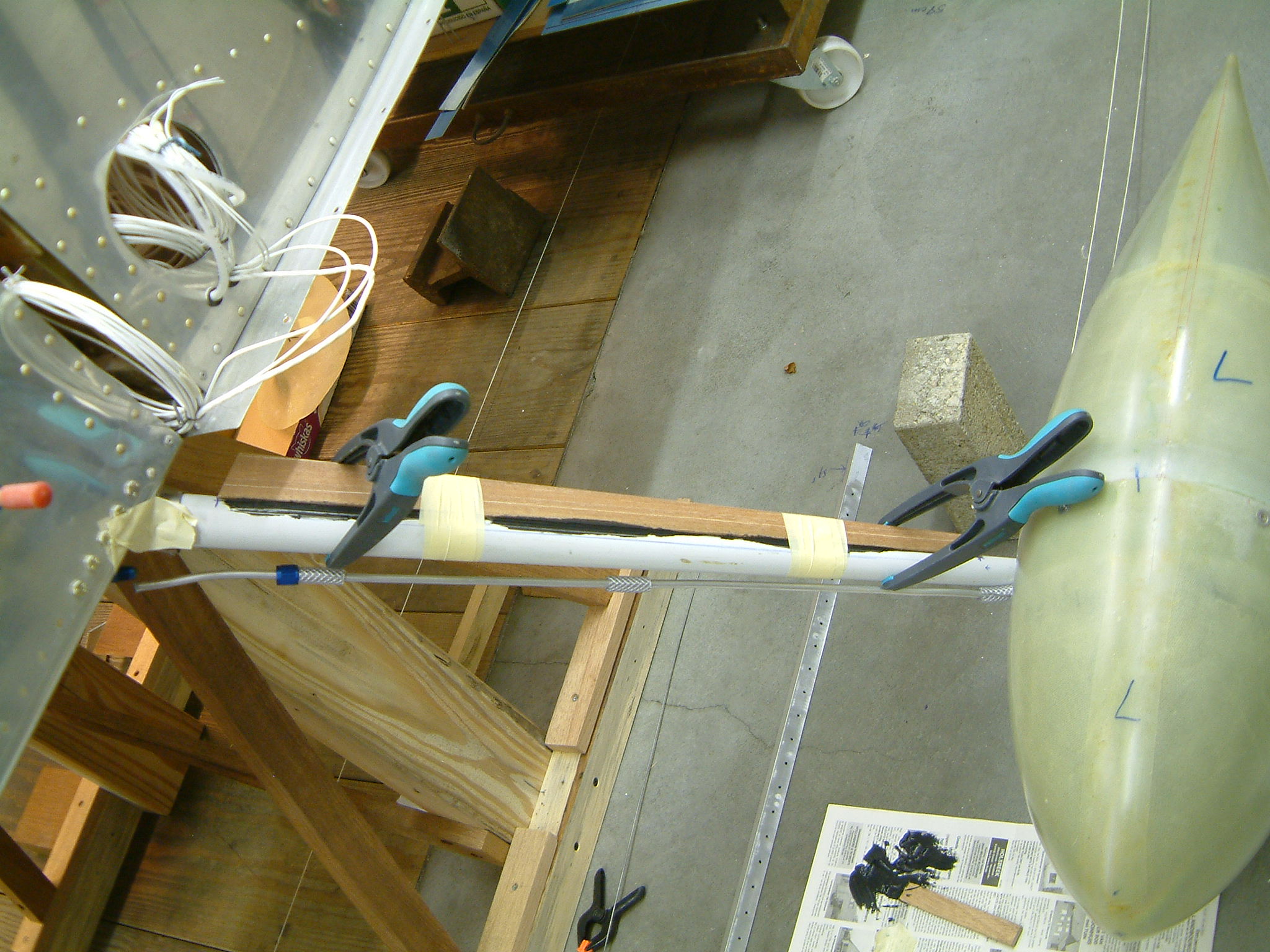

PostPosted: Fri Jun 22, 2007 1:50 am    Post subject: RV7 main gear wood dampeners Reply with quote
We used stiff Meranti (about 700kg/m3) glued with TEC-7 a urethane based strong glue
that remains slightly flexxible.
Théo.
RV-7A
