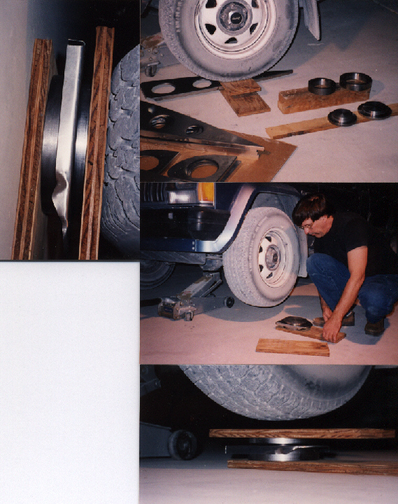

I'm crushed, CRUSHED that Doug considers my "gravity powered lightning hole
press" method as "noise" on the list. The bigger point is that nearly every
builder has these tools (a truck and a hydraulic jack) at their disposal, so
they can accomplish the task with ZERO additional investment. Sure it's
overkill, but you can do it without spending a dime, nor juggling "C" clamps
AND a vise. When you are pressing the lightning holes in a 12' wing spar
web, how handy is that to hold in a bench vise?
I am attaching the pic of my operation for the benefit of the new guys.
This is again, old hat for the list oldtimers who will cringe at viewing it
again, I apologize in advance.
The steel dies shown were used as shown, but they can just as easily be used
in a hydraulic press or other pressing method.
They were made from ZA prints and have been used by several builders so far
with no problems.

I lent them to a 601 builder who had a problem with one of the dies. One of
the holes requiring flanging on a 601 is within a channel, so that
particular die needs to be altered (edges trimmed) to fit within the
channel. If they ever arrive "home", I will do this conversion to work with
the 601. As they are now, they do everything required on a 701.

I also found that the noise on this forum about the need for hydraulic
presses is overkill. So is using a car to provide the pressure.

"gravity powered lightning hole press"
Sorry, I'm building my plane on the International Space Station. So no
gravity is available (or only micro-gravity).
-- Craig

If the gravity press works for you, by all means use it. I tried it, but only managed to split a set of dies made of oak. It was this experience that lead me to the plywood solution. And you do have to admit, it IS overkill. I quickly realized that the effort to spin a vise handle is miniscule compared to getting out the floor jack, etc.
The point I WAS trying to make is that the amount of pressure required is actually very low; not at all what I had initially imagined when talk of hydraulic presses and car weights were put out here.

Nice looking dies. They look just like the one's I'm using. To do the squash I just put a big 3/4 inch bolt through the center and torqued down. Why the need for the car? A big bolt works just fine.

Because I had a Truck and a hydraulic jack, I didn't have a 3/4 inch bolt.
Do you know how much those things cost these days?
Randy, Las Vegas do not archive

Home Depot all thread 3/4 inch, $9. Two 3/4 inch nuts, about $1.50 each.
