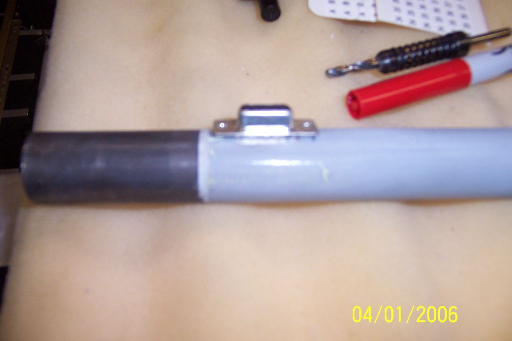

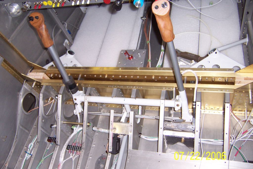

Grant, here is what I did. Simple DB9 connection above the slip joint. With
the seat pans in, connection does not hit anything and works in the open
area u-shaped area of the seats.
I have a four way hat switch, PTT, and CWS for the AP.
Hope this helps.
Bill S
