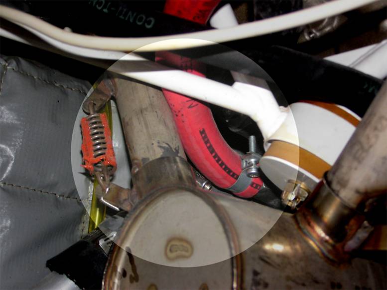

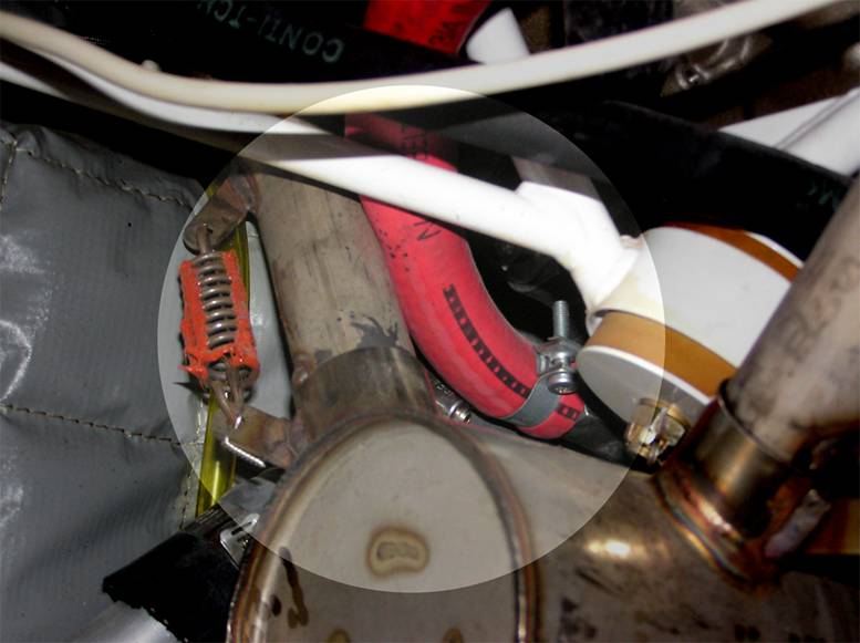

Hi all,
I have a Kitfox Classic IV with a Rotax 912 UL engine. I’ve started the engine and run it a few times and now I’ve noticed something I don’t care for. The water pump for the cooling system is on the bottom aft end of the engine. Lines come out of the pump and run up to the cylinders. The line that comes out of the port side of the water pump runs directly toward one of the exhaust pipes. That line needs to make a 90 degree bend on the way to the cylinders. The exit from the pump is so close to the exhaust pipe I don’t see a way of running it without the line pressing against the exhaust system. I’m wondering what other builders on the list have done to avoid this conflict.
Thanks for your advice,
Ken Davy
Kitfox Classic IV N1701S
Rotax 912

The picture looks like it is actually laying against the pipe. Is that true? If so looks like a might poor design by rotax. Perhaps the line needs a 45 degree elbow so you can turn it and route the line away from the pipe. Over time that coolant line is going to fail. Personally I never cared for hose type clamps on aircraft. Converted mine to fittings. Lots of work but many advantages. I used hard line where possible and braided Teflon else where. If you must stick with regular hose and clamps might take a look at silicon hose. You can get different sizes, lengths and pre-molded bends.

My mind is a bit fuzzy but I do recall having to replace fitting under the engine with ones which had different angles to probably avoid what is happening to you coolant line. Perhaps some one else remembers this. The fittings came from Skystar. The original ones in the engine had to be heated to break the thread sealer. My engine was purchased separately. John McBean would know the answer to this.

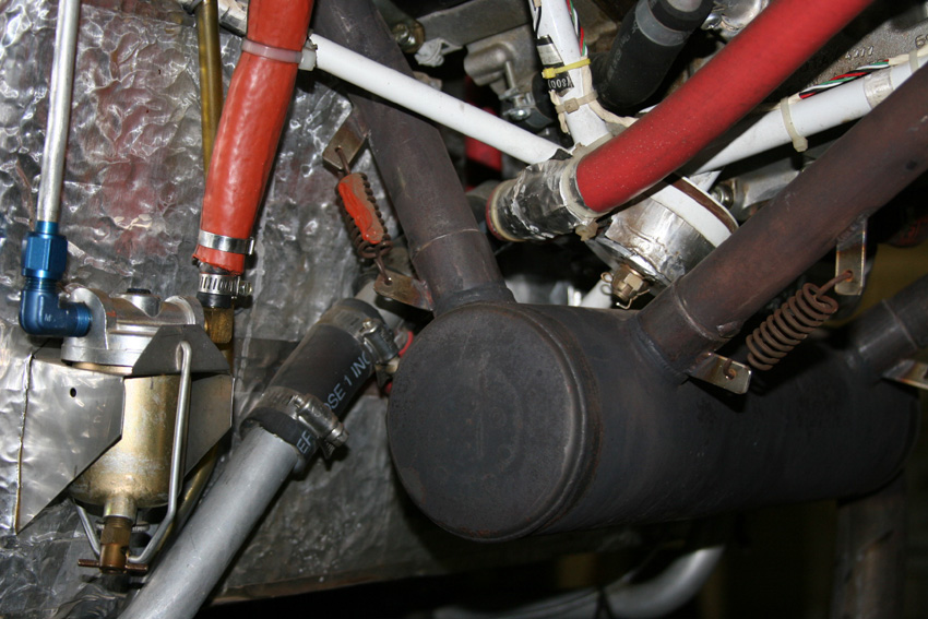

Looking at my installation, I routed that particular line to the forward
cylinder as in the attached photo. The line to the aft cylinder was the
upper line from the pump spider. In further looking at your picture, I
guess I don't understand what that line is going to. All the upper cylinder
coolant lines terminate at the Spider tank and the lower lines run from the
pump. What fitting does that line run to?
Lowell Fitt

I agree with you completely. Rotax should have engineered that better than they did. But unfortunately we have to deal with it now.
First things first - do not fly your airplane with the hose as shown in the picture you sent. You are destined to experiencing an engine failure as it is, so you need to change it as soon as possible.
I heard converting to a metal line will not work long term due to vibration fatigue on the line, so what I did was installed high temp resistant silicone hose (napa as I recall had it), and then covered that with a heat and flame resistant sheathing like they use on race cars (also available from an auto parts store). It is made to fit right over the hose, and is typically silver in color. But even after doing all that I made sure the hose didn't touch any of the exhaust, using hose clamps and tie wraps to keep it away. As a final measure, I wrapped the exhaust pipes themselves with race car "header wrap" (also available at auto parts stores). Doing all this provided three separate measures of protecting against melting of the hoses.
Might sound like overkilll, but if that coolant hose burns through, you will quickly lose all your coolant. I've been told a 912 will get you back to the airport without coolant, but it is going to be expensive to fix once you get home as you will probably have lots of engine warping damage.
I would also make a point to handle the oil cooler hoses similarly. Mine were very close to the front exhaust pipe, so it is a potential problem as well. In fact it is worse. You probably won't make it back to the airport without oil....

I pulled the cowling this morning and looked at mine. Now is this line going to the front cylinder on that side. If so, pull the hose and route it direct to the fitting at the cylinder, meaning go on the other side of the mount(lower part of mount and tubing, don't go over the top), mine does this and clears the exhaust by 1/4 inch.

I remember just heating my fittings with a heat gun and turning them to better place the hose then wrapping them and the exhaust.

I notice you also have RTV (Red) on your rear muffler spring buy not on the
front one. I noticed the same thing on Ken's picture this morning but yours
has the RTV on only one spring. I have being trying to figure out the
reason for this RTV. It can't possibly to make the springs quiet because
you couldn't possibly hear the springs over the noise of the engine.
Still curious.
Noel

I have it on both, It is on the back side of one - out of view. Regarding
rust. I hope to never see it in the engine compartment of my IV.
Lowell

I don't have quite as bad a problem as you but I applied a lot of heat shield of stainless steel to protect hoses from the exhaust pipes. I do not recommend wrapping exhaust pipes, it will defnitely make them fail sooner.

Rick: The picture looks like it is actually laying against the pipe. Is that true?
Yes. It rests right against the pipe. I’ve only run the engine a few times and I’m already seeing a scorched spot on the radiator hose. It’s one of those things that you look at a hundred times and don’t really see.
That’s what I was kind of thinking at first. The current fitting comes straight out of the engine pointed right at the exhaust pipe only a couple of inches away. Ted suggested I contact John McBean to see if Skystar has the proper fitting. If Mike’s suggestion below doesn’t work, I’ll give John a call
Lowell What fitting does that line run to?
It runs to the bottom of the front port cylinder.

What I did was installed high temp resistant silicone hose (napa as I recall had it), and then covered that with a heat and flame resistant sheathing like they use on race cars
Sounds like good advice anyway. I’ve looked at replacement oil hoses for the Rotax. Off course they’re an odd size. I think Lockwood has oil and radiator hose that are the exact size but cost quite a bit more. Spruce has oil hose with an inner diameter that’s within a millimeter or two that’s a lot less. I’m guessing that the NAPA silicone hose is not going to be an exact replacement either. Close enough? Will a tight hose clamp make a millimeter or two not worth worrying about?
I’d really rather not find out.
Mike: I pulled the cowling this morning and looked at mine. Now is this line going to the front cylinder on that side. If so, pull the hose and route it direct to the fitting at the cylinder, meaning go on the other side of the mount(lower part of mount and tubing, don't go over the top), mine does this and clears the exhaust by 1/4 inch.
I’ll defiantly take a look at this when I’m at the airport tomorrow. If I recall, I got just enough hose with the kit to barely make it.
