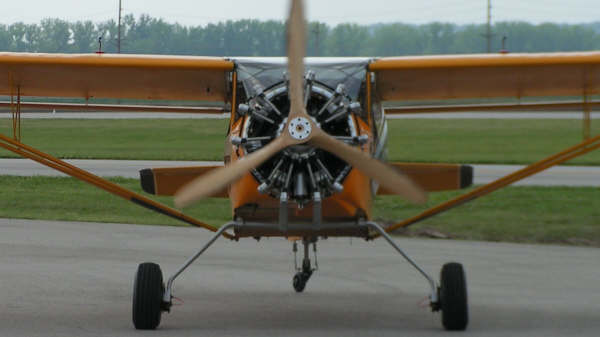

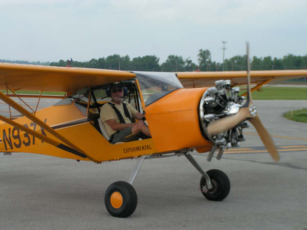

I recently installed a Rotec R-2800 7 cylinder radial engine in my Classic 4 Speedster. Runs good. John Murphy , St. Louis
