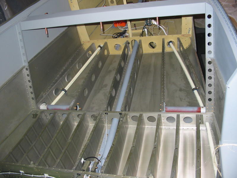

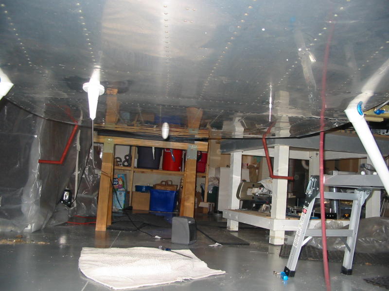

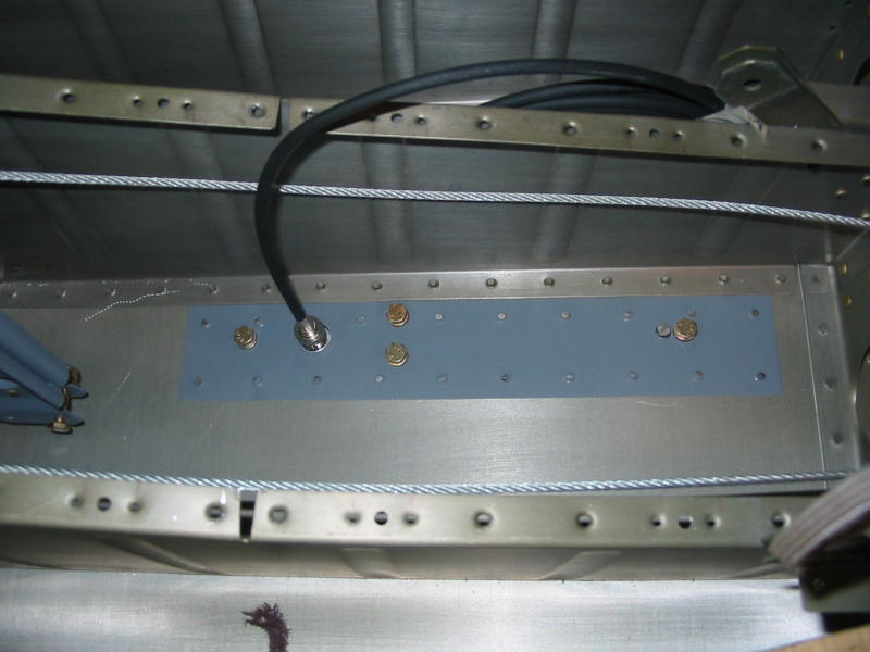

I mounted my marker beacon antenna between the rear seats. No problem with pushrod or rudder cable interference. I mounted the bent whip antenna under the passenger seat. You don't want the bent whip antenna too far aft as it will get closer to the ground during takeoff rotation and landing flare / aerobraking the further back you mount it. Pictures attached.
-Jim

I don’t think between the rear seats is a good place for an antenna. The control rod is so low there that I think it would be too risky to have anything sticking up from the belly skin there. One possibility for a bent whip is to put it under the baggage floor (with nutplates in the skin), just off center, and then you can either get at it through the lightening holes or you can put in an access panel. I wouldn’t put an access panel under the rear seat floor because there has to be some structural reason that there are no lightening holes in that area. Has anybody had any problems putting them under the front seats, one on either side? I seem to remember someone mentioning that the gear legs can get in the way. We haven’t tested them, but have very good reception with that arrangement.
Jesse Saint
