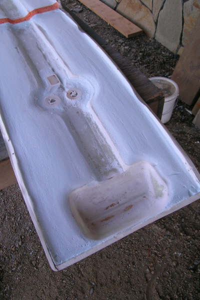

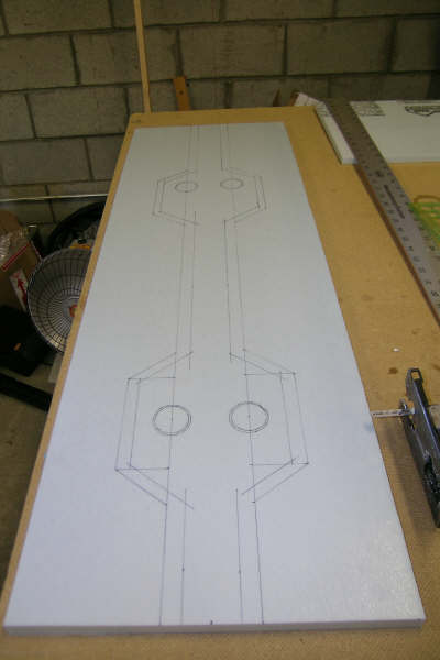

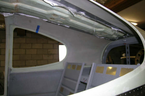

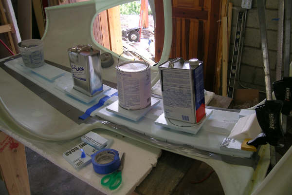

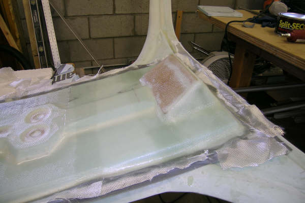

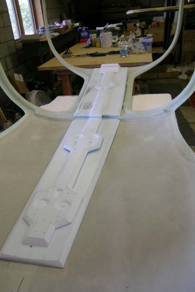

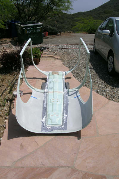

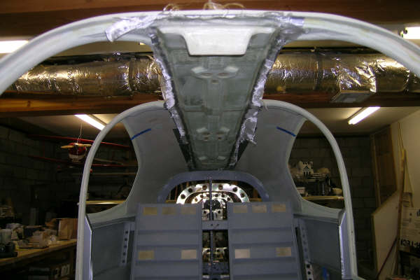

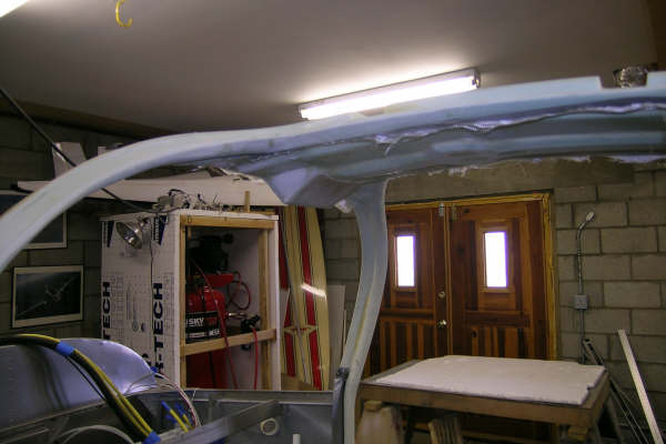

A few weeks ago I received some photos from builders that depicted the style
of many different overhead consoles. Mine will be done once I mount the
switches and LED and the velcro and Zolatone it, but here are a few photos
that show how versatile working in composites can be.
The last photo is the underside after the foam has been carved out. Total
weight is about nearly 4 pounds.
2 laminations of six once glass on the outside and one layer of three once
on the inside. Actually working in fiberglass can be very creative and fun
so don't let your introduction to them by working on Van's parts turn you
off...it is not an accurate reflection of what it is like.
John G. 409
