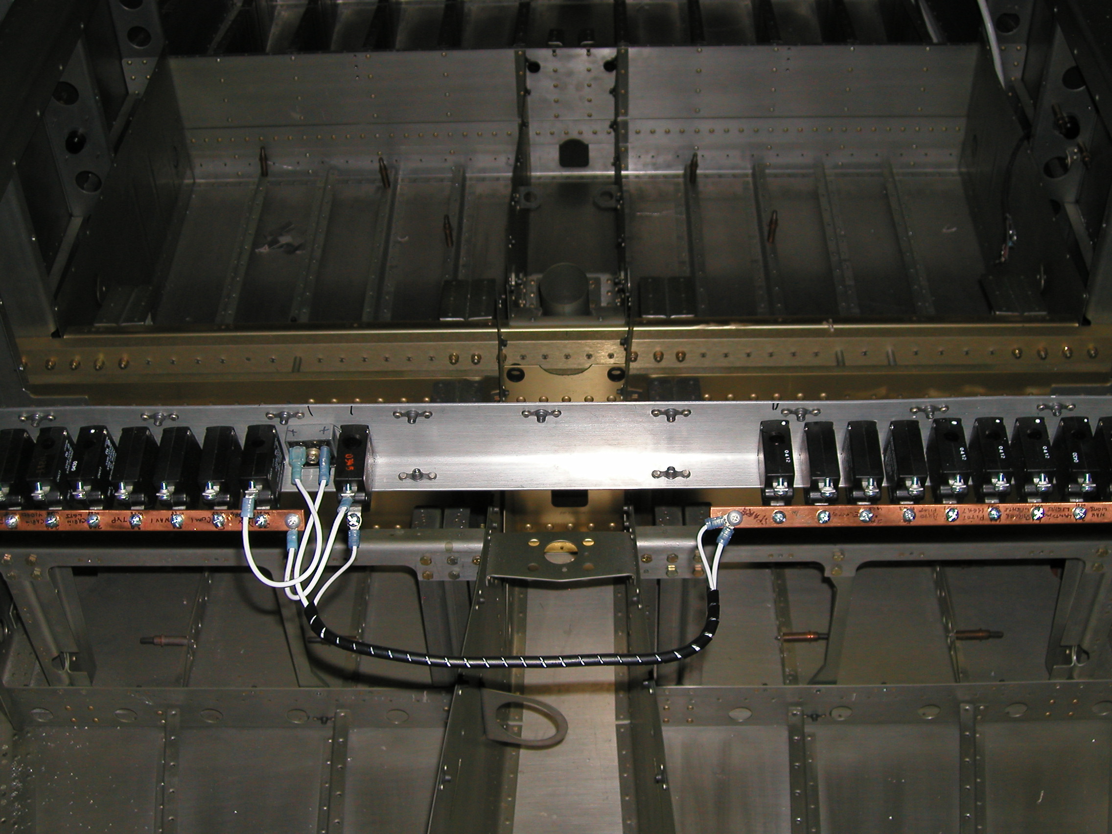

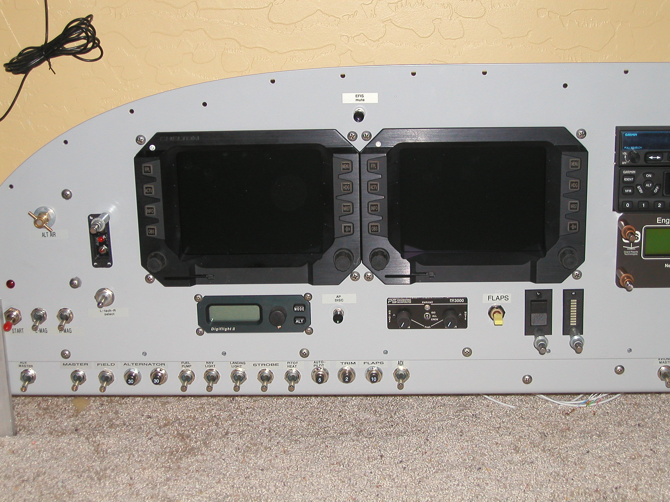

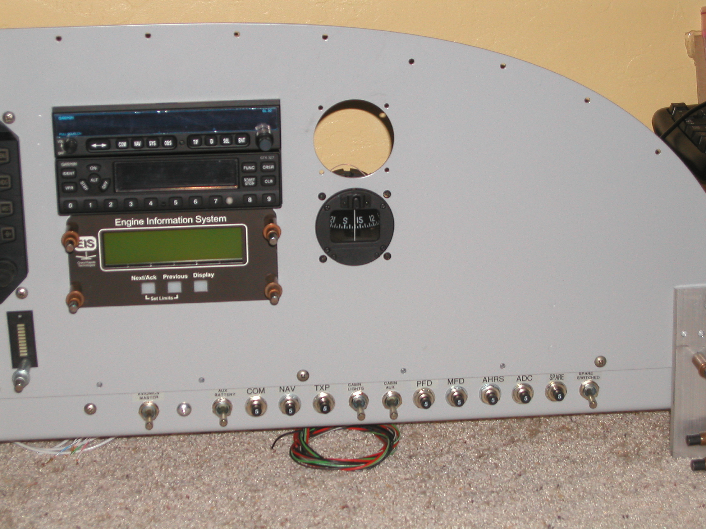

dlm46007(at)cox.net
PostPosted: Fri Feb 10, 2006 8:01 am    Post subject: Toggle Switch Breakers Reply with quote
Here's my setup. Everything must be pullable or toggable. see the pictures.

brinker(at)cox-internet.c
PostPosted: Fri Feb 10, 2006 12:52 pm    Post subject: Toggle Switch Breakers Reply with quote
David that is a nice clean wiring set up, you have given me some
idea's. What type (gauge,size) of aluminum angle are you using to mount
your switches in ?

dlm46007(at)cox.net
PostPosted: Fri Feb 10, 2006 3:34 pm    Post subject: Toggle Switch Breakers Reply with quote
I drilled the standard crossmember and drilled corresponding holes in the
bus bar which is copper .125 x .5 x length. I believe I bought the copper
in 24" lengths. If additional rigidity is desired one could rivet an
aluminum angle along the bottom end of the crossmember. My panel is .090
