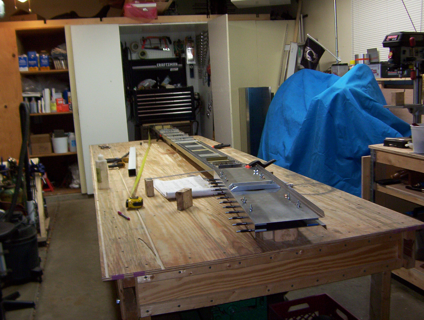

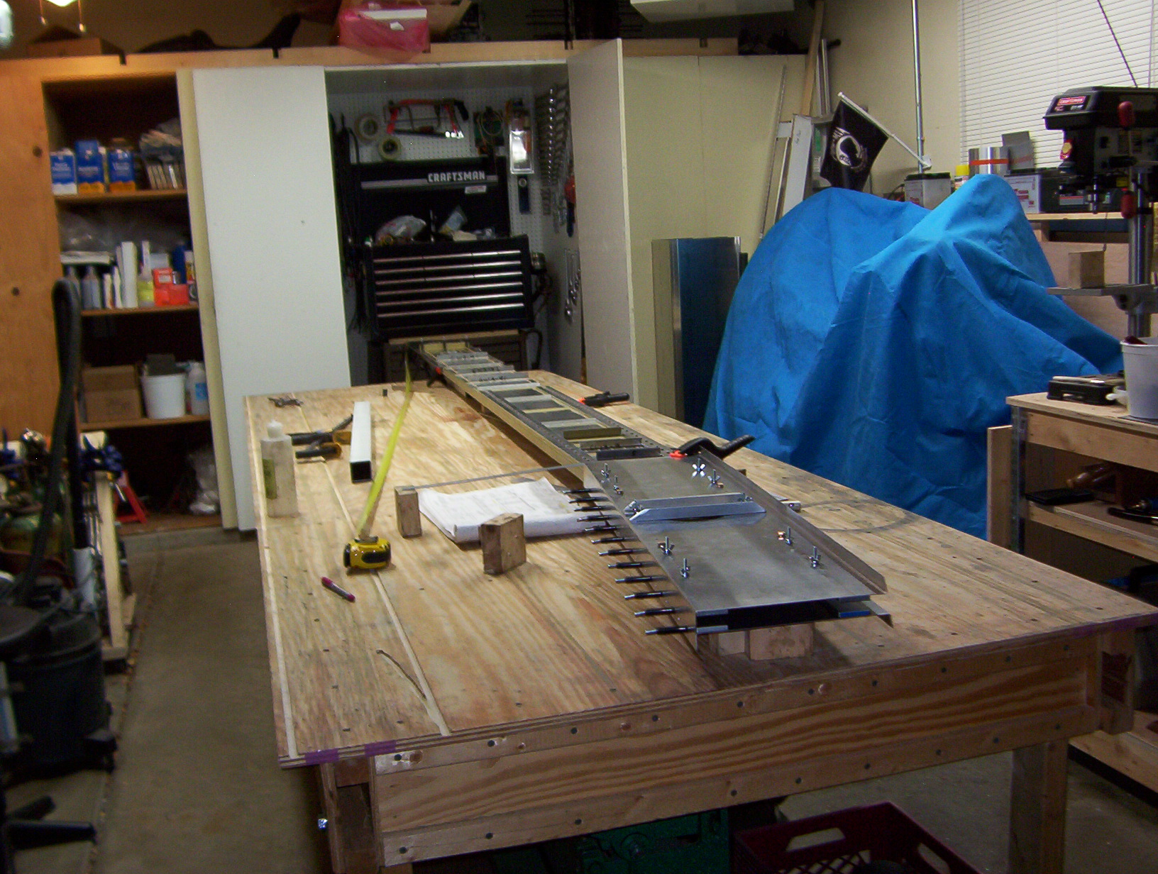

Well I guess I better put the center of that center wing spar in the center of the fuselage because that is where I measured everything from when I set the dihedral on the bench. Did one wing spar at a time like the picture below. Center spar was pilot drilled 1/4, marked the wing spars then drilled them then reset the wing spar and checked dimensions when it was bolted with 1/4, opened the holes one hole at a time while the center and wing were in final position. Let me know what troubles this might give me.

Ron Lendon wrote:
Andy,
I noticed you mentioned you only drilled one side of the center spar. I set the dihedral of both wing spars and the center spar before I began the wing assembly. Did I make a mistake here? Should I have waited to drill one end till later? Why?
I only have one wing spar so far. Smile The center spar is hanging on the wall. When I'm ready to drill the other I'll set that up flat on the table and set that dyhedral and drill that spar.
Sounds like you made both spars at the same time.
ashontz
Joined: 27 Dec 2006
Posts: 723
PostPosted: Mon May 21, 2007 6:56 am    Post subject: Re: 601XL Fuselage build before wings Reply with quote
This can be done one at a time I believe. The plans show the tip height about the center spar. Shouldn't really matter if you do one at a time or both at one, what does matter is that the line drawn to the center spar is parallel to the center sparline and the perpendicular line up to the parallel line from the tip is the measurement called for. In fact, this is hard to do with both spars at the same time because then you need a 27 foot table to do it right.
This is exactly how I'm doing mine, I just don't have the second spar yet. Doing them both at once requires a 27 foot table. I doubt that was Zenith's intention. Even doing them both at once, you still have to guarantee that the center spar is parallel to the line intersecting the tips, which is exactly the same as insuring a parellel line for one spar at a time. I think you're fine they way you did it.

Ron Lendon wrote:
Yep, I did them both at the same time. When both right and left are symmetrically opposite its faster to make both parts at the same time.
You didn't have the 3 spars all setup together as a 27 foot assembly though for drilling the main attach holes, right? You just did the right spar to the center spar then took that apart and setup the left spar in the center spar.
My center spar is now hanging on the wall. Once I make the left spar I'll set the dihedral for that.

PostPosted: Tue May 22, 2007 6:03 pm    Post subject: Re: 601XL Fuselage build before wings Reply with quote
You are correct, I setup the right and center spar then repeated the process for the left and center spar. Pretty much just followed the directions on the 6-W-4 drawing and built the right triangle 3588, 3605, 355.
