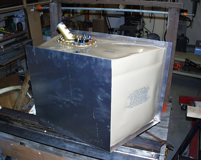

tlc2(at)telus.net
PostPosted: Sun May 20, 2007 3:55 pm    Post subject: HEADER TANK Reply with quote
Below info from Gary, whom had a Custom made Crash resistant racecar type fuel cell from below contacts......Don't know if size would be an issue for a smaller header jpeg attached of his tank>>>
