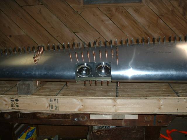

PostPosted: Wed May 16, 2007 2:53 pm    Post subject: Need help on elevator Reply with quote
Hans-
Put a strip of duct tape on both sides of your line, leaving enough room
for the thickness of a sabre saw blade. Then, use a blade suitable for
aluminum to cut the opening. That's how I accomplished the cuts in the
attached picture.
Good building!
Bill Naumuk
HDS Fuse/Corvair
Townville, Pa

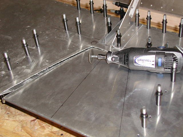

PostPosted: Wed May 16, 2007 5:08 pm    Post subject: Re: Need help on elevator Reply with quote
I used my dremel (see the attached pic) to cut fairly close to the line and then filed the rest straight and smooth. Get a good grip on the dremel just in case the wheel bites should you go too fast.
