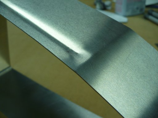

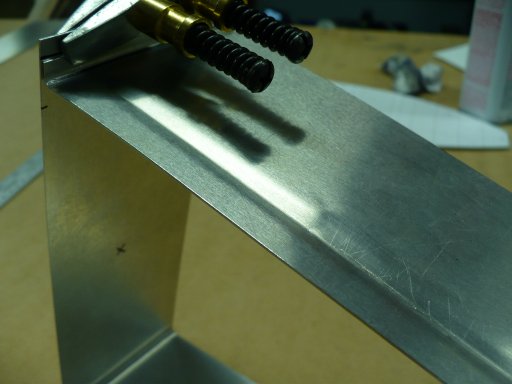

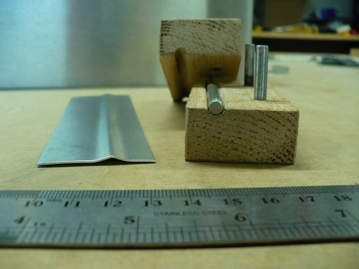

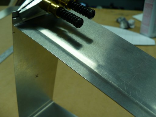

Yesterday evening I made the simple bead block press to create the bead on the fuel tanks. The result is pretty good, but it requires a lot of pressure with my vice on the .032 Al, also you have to do it in steps to keep the bead nice and smooth. If I want to continue this I will also have to make a smaller block that allows me to follow the curves of the fuel tank. The attached images show the the little oak bead press block that I made and two images of results on a bending test strip that I worked on to test the location for the fuel tank bending. I'll continue working on this an report my results.
Maarten

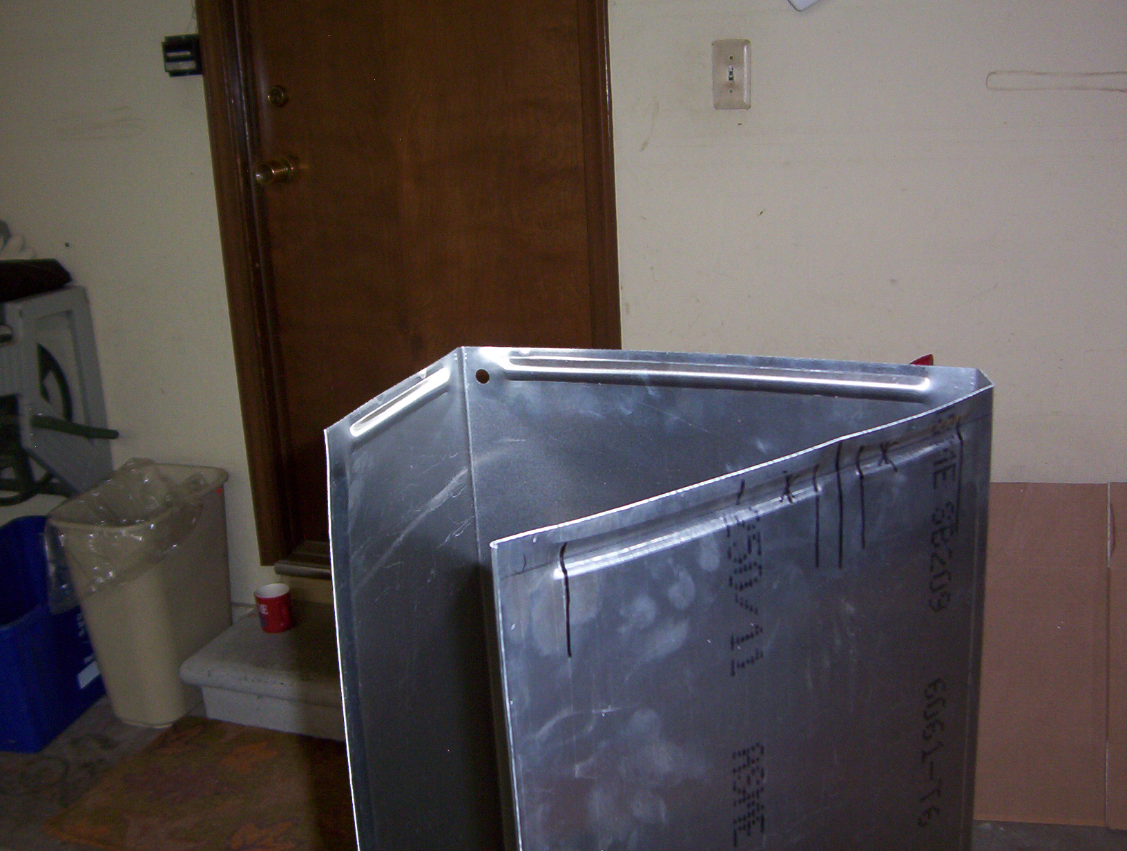

PostPosted: Tue May 15, 2007 5:29 pm    Post subject: Re: Rolled bead for fuel tank Reply with quote

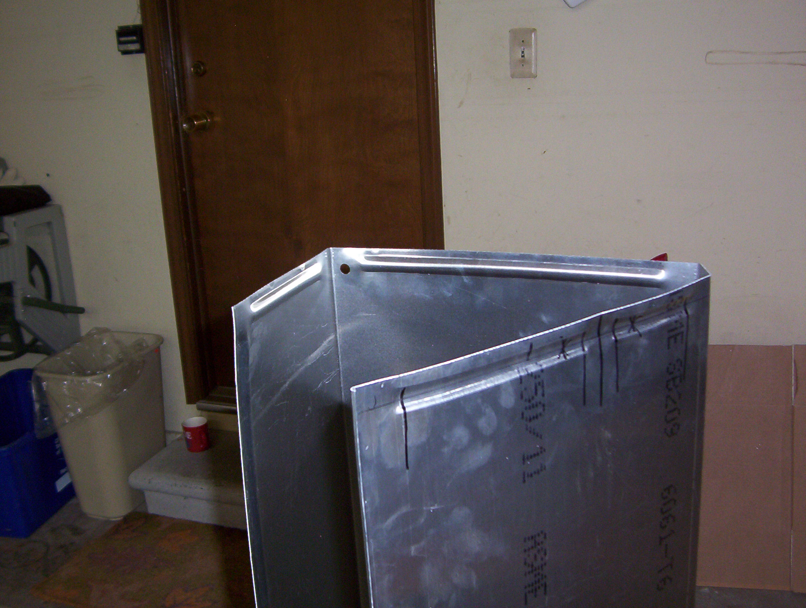

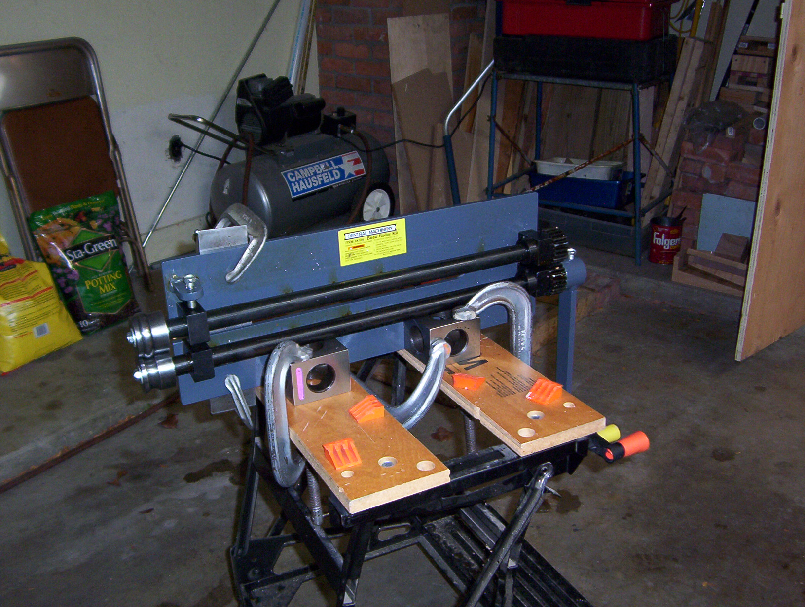

Here are some pictures of the setup used for putting the beads in the tanks. One pass gets the depth and just used a mark on the closure screw and counted turns to get the same depth each time. I clamped a (1" x 3" x 7" steel block), near the die end to keep things inline. Also polished the tools to get a better surface finish, no marks on the sheet metal.
Kitlog entry here: http://www.mykitlog.com/users/display_log.php?user=rlendon&project=113&category=0&log=24682&row=128
