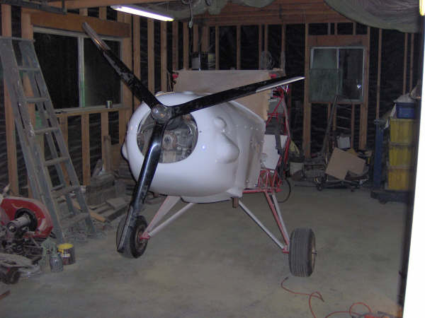

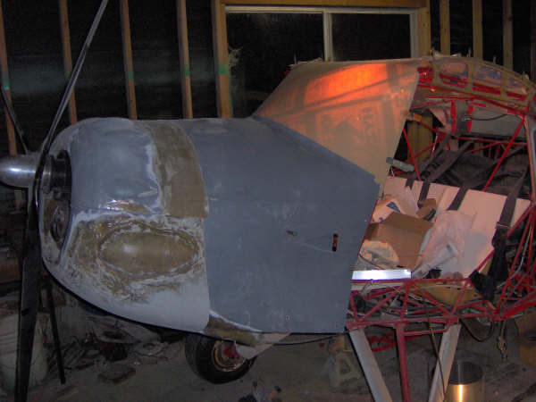

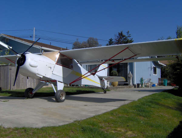

John heres a picture or two of the glasswork to make a redrive VW fit. It
was bulky looking at first, but looks great on the field now.
Ron NB Ore MK IV Speedster, 1915cc VW, 1.6:1 redrive, 72" Ivo ~60
hours
