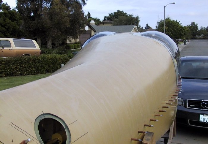

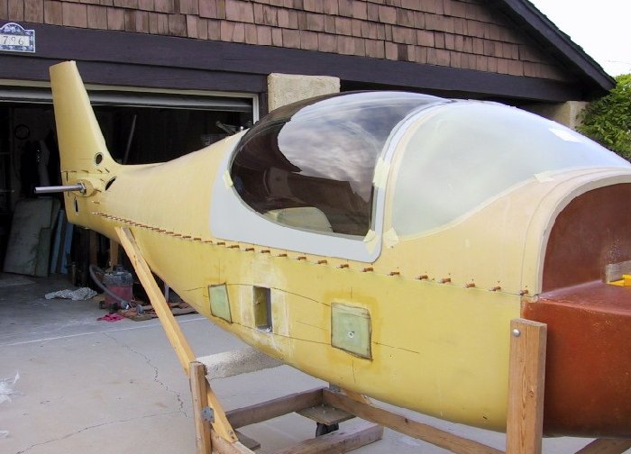

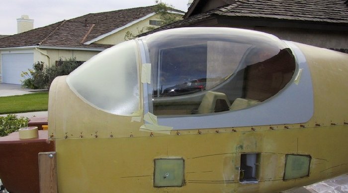

mau11(at)free.fr Guest
Posted: Fri May 04, 2007 9:59 am Post subject: Europa Widen Shoulder width door mod. |
Hi Will,
I sent to you the pict with this mod.
Michel AUVRAY Builder 145
F-PFGT 300 hours flight

dglauser(at)gmail.com Guest
Posted: Fri May 04, 2007 11:07 am Post subject: Europa Widen Shoulder width door mod. |
Hey, that's my Europa!
That is not a photo of the door sill mod. That is a photo of the
bubble canopies placed in position. I was trying to decide if I wanted
them or not. I decided I'd rather have the regular windows, but
haven't yet gotten around to advertising. Anyone want to work a deal?
David
