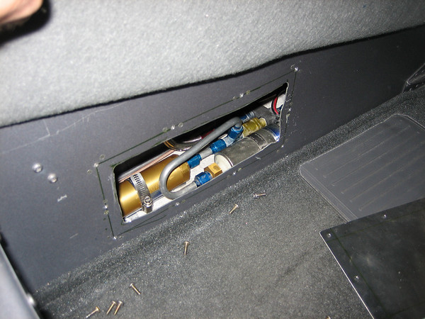

Sorry, I took so long to post this picture. Here is a shot of the access hole I cut into the tunnel to check fuel filter.
With the throttle quadrant I have it is much more difficult to gain access from the top.

Just curious? Did you cut in the access panel blind or did you have to remove the console for the install?
I'm lucky to be at the point where cut-in will be easy. In fact I think I will go do it right now.

I did remove the console to make sure I was not going to hit a fuel line plus I wanted to to place it as close to the fuel filter as possible.
I took everything apart to install my O2 system. But after 3 hours of thinking and planning I decided to send it all back and just use a portable system. Works great, just throw it in when you need it.
I cut the hole at the same time.

Could you post measurements from some reference points so when I cut the
access panel it will be close to the fuel filter?
