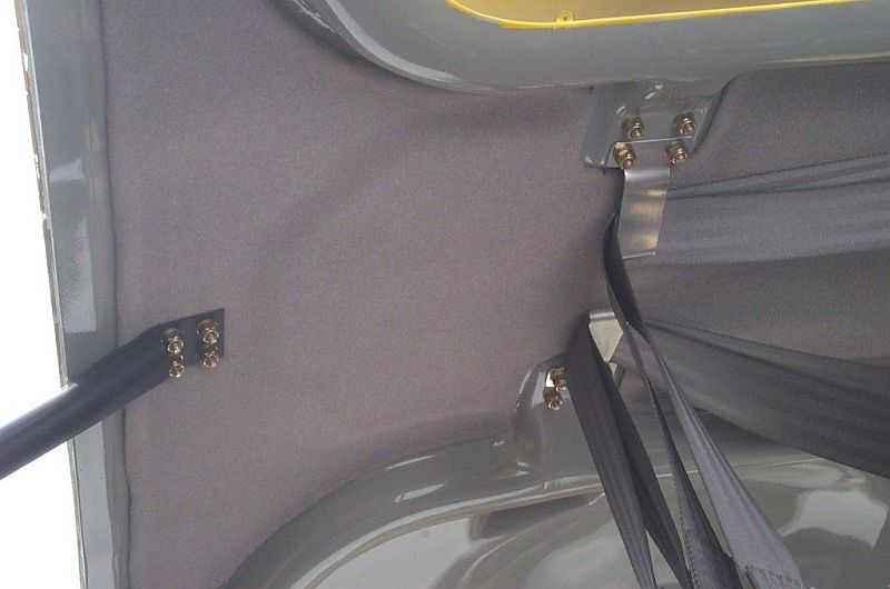

Tim Olson
Joined: 25 Jan 2007 Posts: 2882
Posted: Thu May 03, 2007 7:13 am Post subject: Overhead Seat Belt Holder Attach |
They do bend down some, but just use a little stiffer material
and they'll stay pretty good. They're plenty loose to
just slip the belt in. When solo, I can leave the other
belt in, but the buckles jingle, so I usually pop it out
and let it sit on the back seat. I attached a photo that
I dug up that was in the photos area of my site. It's
the hangers Van's RV-10 has. Mine are a little wider, and
I attached them to the rear door hinge instead of the front,
but the concept is the same.
