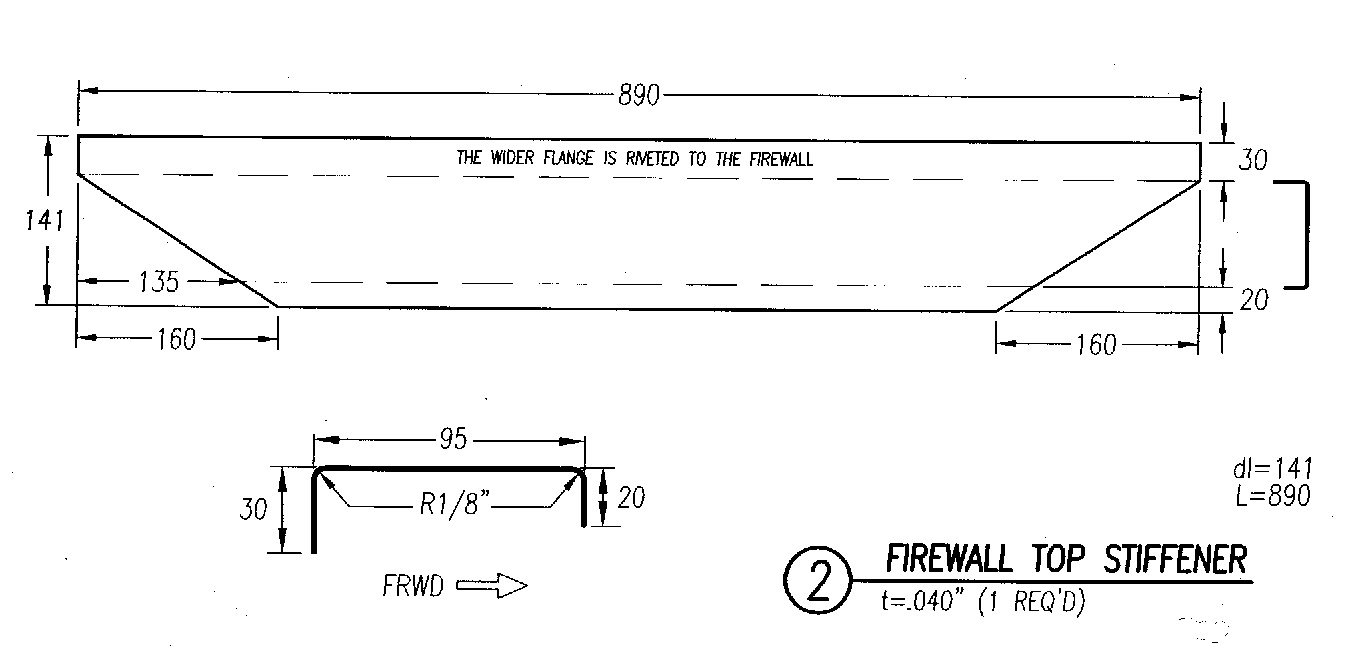

If I were just risking a chunk of .025 I wouldn't care, but we're talking .040 here. Built a 4' Dave's brake over the weekend and this is my first job on it.
The DL of the stiffener blank is 141mm (Top drawing), but the sum of the flanges and center of the finished piece (Bottom drawing) is 145mm. Am I supposed to add 2mm/side to the DL to account for the 1/8"R? Makes sense, but my question is, is this drawing the norm or an exception so I know what to do in the future?

No matter what theoretical answer you get I would cut out a narrow 1-2 inch wide cross section test piece, bend it and check the results.

I just noticed that another part on the same print page had a DL less than the finished. Maybe the metal gets stretched during forming. I might be overanalysing.

The DL always seems to be less that the total sum of the lengths. The best example of this is the standard "L", The plans show each side as being 19mm (38 total) yet the DL is 36mm. I don't think it is the metal stretching during bending, but in some mysterious way, once the part is formed, you are measuring the bend radius twice, once from each direction. I think that allows for the missing material, right?

I forgot to mention I agree with Craig that one should make some test bends, especially since you are usuing a new brake. You will find a
"sweet" spot somewhere under the nose of the brake tongue where when you position your stock with the bend mark, once you bend the metal, your mark will be in the center of the radius. I've sent pictures before showing bending standard "L" on the TAPCO siding brake. I've found that if I shove the metal under the tongue, so that the bend marks are barely visible when "eyeballing" them at about a 45 degree angle from above, puts the marks in the center of the bend radius every time. This is not too crucial when bending "L" etc., because if your off a little, you just wind up with one leg of the "L" a little longer that the other. But when you are bending channel, where you are trying to wind up with a specific channel width, you need to know where to locate the bend marks on YOUR brake to accomplish the correct radius, located in the right place twice, to accomplish the finished channel width.

The numbers from current XL plans (6-B-7 dated 03/06) are the same: The flat piece measures 141 deep. The two flanges are listed as 30 and 20. After the bend the three sides are 30, 95 and 20 with the developed length given as 137.
I've read a number of definitions of developed length and still don't see how 137 fits in to all this. In what way (if any) do I have to apply 137?
30+95+20=145. I agree with Randy that difference between 141 and 145 in part comes from double counting the curve.
On the other hand IMHO this is one part where the dimension of the two legs of the "U" could end up being over a bit and not cause any harm. I may be overlooking something but I don't see where some extra length in the legs would interfere with another part (at least on the XL).

When I lay it out at 30 x 95 x 20 in 0.040" thickness, add the .125" bend radius, the outer surface DL is 141. The inner surface DL is 138. Looks like the 141 is good.
I have always made the bends then trimmed the flanges when I did not have production tooling to position and feed the workpiece...

BTW: on the current XL plans this piece is made of 0.063, not 0.040. Is that why the listed DL is different: 137 on the XL vs. 141 on the HD?

If fyou want to work it out for yourselves, check one of the following for the formulas: AC43.13-1B/2A, AC65-15, Tony Bingelis' books on homebuilt fabrication.
What you are seeing is the difference between the two side measurements of the .125" radius and the length of the arc swept in that corner.

You're seeing the "setback" or "bend allowance".
http://www.engineersedge.com/bend_allow_calc.htm
The "DL" (developed length) will always be smaller than the totals of the
flanges because of the radius in the bend.
Don't sweat it too much, just be sure your parts nest together nicely.

.040 bends a lot harder than .032. Don't center on the edges of your brake, center on the hold-down bolts. Still works acceptably well. I wound up with 32mm, 22mm, and 95mm, which is what I was shooting for.
WJN
[quote] Tom-
I tried a test piece and found out two things.
1. The DL is adequate to come up with the finished part. Probably a combination of material stretch and a trig compensation for the radius.
2. Dave says you can build the brake out of either 3" or 4" angle. WHAT FOLLOWS IS NOT A SLAM AT DAVE!! Sometimes a solution is so simple you can't believe you're so stupid. Standard 3" angle is 1/4" thick, but 4" is 3/16". I built mine out of 4", because that's what they had at the junkyard. It never occurred to me that a larger angle would be thicker. Duh! I'm not worried, because the additional radius makes for a stronger part, up to a point. 1/32"R is not that point.
The target dimensions were 20mm and 30mm flanges, with a center section of 95mm. Going right to the flange lines, I wound up with 23mm, 33mm, and 93mm. So if I cut down on the flange mark lines by 1mm, I'll be right on for the center section, and within +/- 2mm for the flanges. As good or better than kit parts.

Thanks for the kind words, Bill. I built my brake from 3" angle and didn't realize 4" was thicker. I'll be sure to change the plans to reflect that fact.
By the way, I have a link to a great bend line calculator on my website. It was created by fellow scratch builder Larry Winger. It helps take the guess work out of figuring out multiple bends.
Craig's advice for doing test bends, and Randy's comment on finding the "sweet spot" are right on the money.
