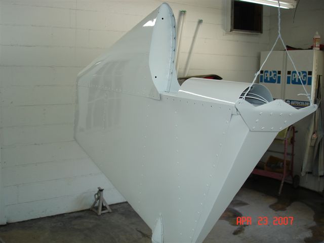

I am painting my 701 project. I'm using Acrylic Enamel. We thoroughly
cleaned and prepped everything and then applied primer, tack coat, second
coat, then a 50/50 enamel-thinner mist which left a very good finish as
evidenced by the attached photo.
Thanks to Larry Martin for his referral to this paint. I think I will like
it very well.

It looks good!!!! Looks like you are getting near the finish stage. You must be getting exicited.

Good job Tommy! The paint looks awesome.

Good job! I'm also starting to paint fuselage as soon as average
temperature rises over 15 degrees celsius. I'm using PGP
Delfleet.

Looks Good! I am nearly ready to paint my 701 and interested in knowing
more.
Can you give details on what you used to prep and prime?
