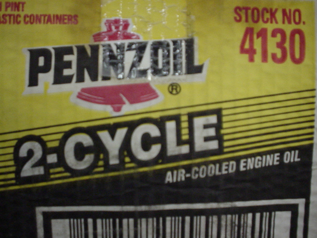

As I recall, Pennzoil Outboard Premium Air-cooled is the recommended oil for
the Rotax 582.

xfire
Joined: 23 Mar 2007 Posts: 16
Posted: Mon Apr 23, 2007 4:16 am Post subject: Re: 582 Oil leak? |
[quote="Fox5flyer"]As I recall, Pennzoil Outboard Premium Air-cooled is the recommended oil for
the Rotax 582.
Deke
Aircooled outboard ?? Been alot of years since I have seen one. I think the outboard and the aircooled are two different oils.

davef(at)cfisher.com Guest
Posted: Mon Apr 23, 2007 4:18 am Post subject: 582 Oil leak? |
Deke,
Pennzoil for Aircooled yes with a API-TC rating.
Outboard oil will have a TW3 or TC W3 rating and it API-TC is not listed
then it is not the same.
Totally different operating conditions -- ie outboards run a contanst
supply of 80F or cooler water. just to name one .
582s in Aircraft need a better oil
Dave
