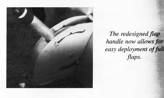

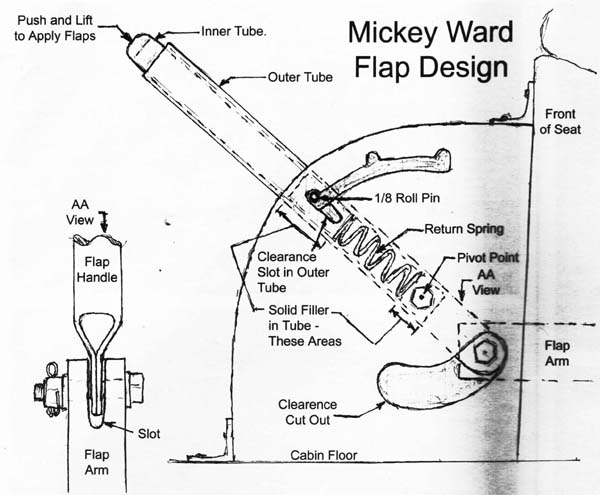

I am working on the forward cockpit of my CH701 kit and would like to find a better flap handle arrangement. Several years ago the Zenair news described an easier-to-use handle extension that had better mechanical advantage. The diagram for this handle from Z-news is attached. I have seen a newer versions that look better. If you have good pictures, construction drawings, or specs for similar handles, or builds them for others, please let me know.
Rgds,
Les
