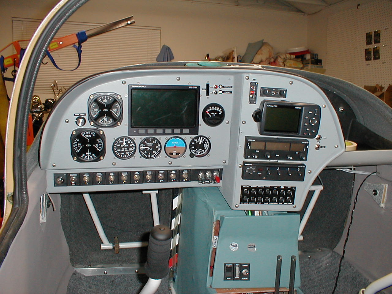

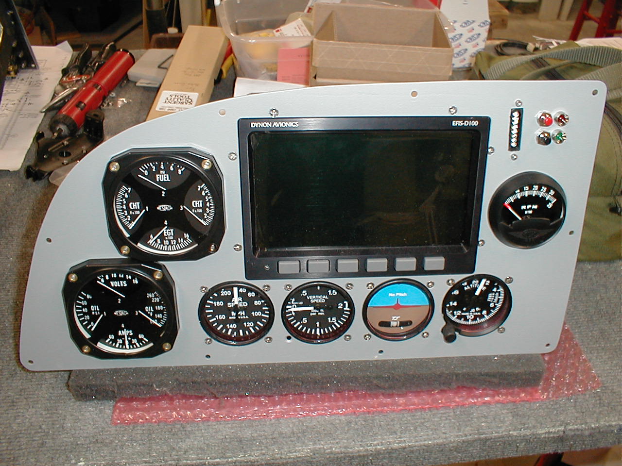

Just got back to my home computer. Here is a pix of my Dynon setup.
