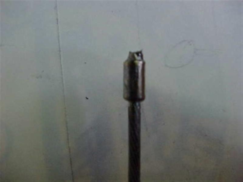

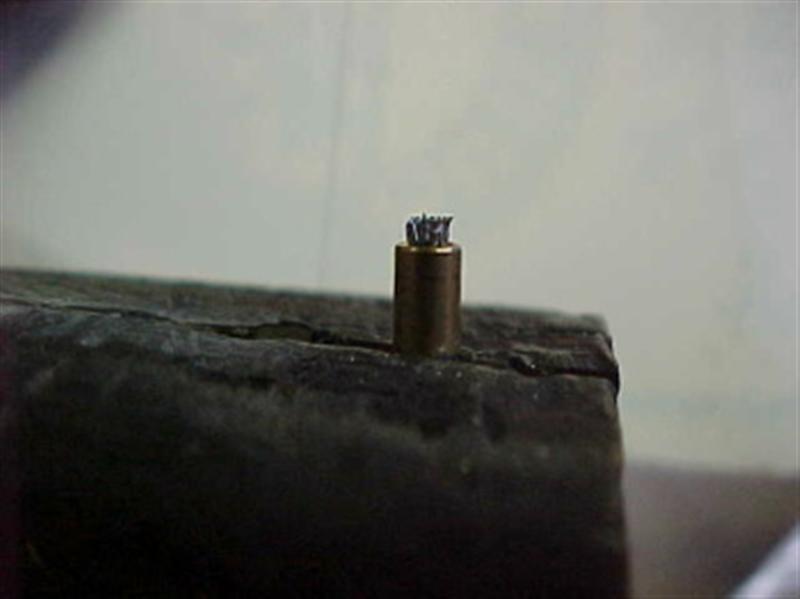

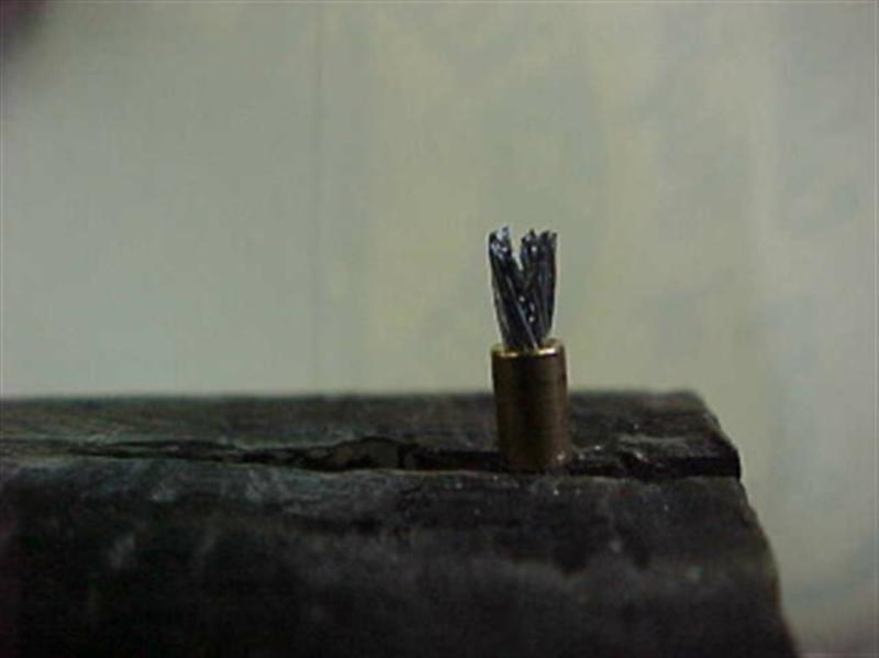

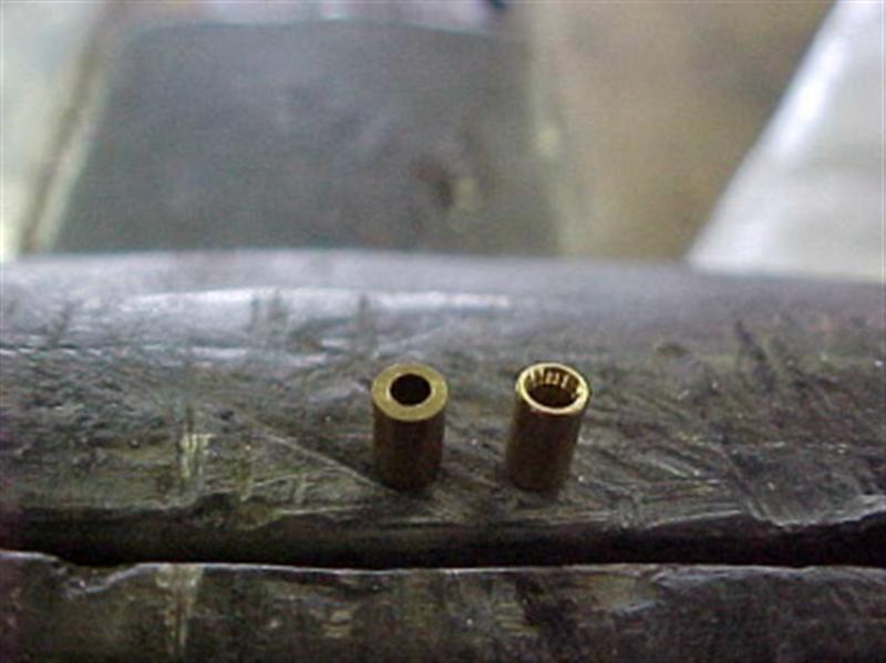

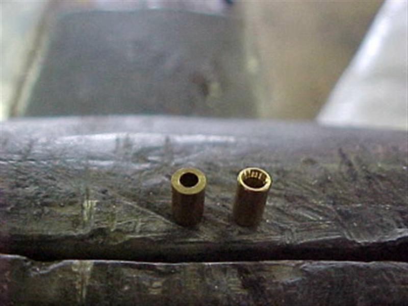

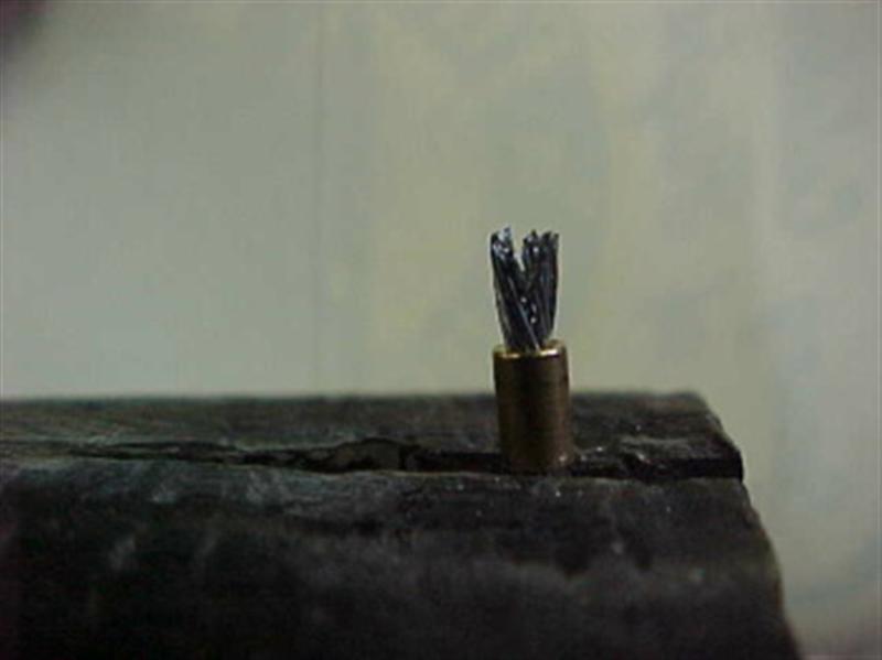

I disassembled the throttle splitter tube and confirmed that the cable
had indeed separated from the splitter assembly. The tiny brass ferrule
that is soldered to the end of the cable (this is what keeps it seated
in the splitter slider) had pulled off. I had soldered this ferrule on
during construction. It was my own workmanship that failed here,
nothing the fault of the Rotax.
After discussing the details with the local A&P at my airport, he
concluded that is was likely a cold solder that caused it to let loose.
His advice was to get a hotter soldering iron (or flame), tin the
braided strands well before flowing the solder in. Even if you are
using solder with flux in it, still apply flux to the braided cable
before you touch it with the solder.
It is fascinating to me how the mechanical failure of a part the size of
an uncooked grain of rice can put you on the ground.
And the 912ul fail-safe design of the carb setup got me home safe. I
love this little engine.
Lesson here is: Give appropriate attention to even the LITTLE details
during your building process. That tiny little brass ferrule needs to
be soldered correctly for it to do it's job.

Good on you, Dennis. It sounds like you handled it real well.   I've done a lot of soldering and silver soldering in the course of my work, and I've seen both cold solder joints, and overheated connections, as was mentioned in another post. Many times now, or even most times, I'll tin each component separately and very carefully, then put them in position and heat them lightly. Make sure you use the correct flux - some can cause corrosion. When the solder flows, it melts together, and you're done - get the heat off it. The advantage to this, especially with different sized components to be soldered, it makes sure both are properly tinned, whereas if you put them together and solder them, quite often the larger component doesn't receive enuf heat and you'll have a cold solder joint. If it does get enuf heat, quite often that will overheat the smaller and burn the flux....then nothing will stick and you'll have an awful time cleaning it up again for another try. Again, as was said, too much heat is as bad as not enuf.     Lar.

I personally would never use a torch to solder a cable. Too risky. It
doesn't take much flame to compromise a cable.
I use a small solder pot I made out of a half inch nut with the one
end welded shut. Heat the nut with torch and fill half full of
solder, flux the cable end and ferrule. Dip ferrule half way into the
molten solder and watch for solder to seep up into the cable strands
above the ferrule, remove and let cool.
Never had one come loose ,,,,,,,, yet.

PostPosted: Fri Apr 20, 2007 6:27 am    Post subject: 912 Throttle Cable Failure Reply with quote
CPS sells replacement brass ferrules, and here is how to guarantee the wire
will not pull through. One end of the ferrule is countersunk, the other is
square cut, apparently to make it easier to slip over the cable. Slip the
ferrule on the wire backwards so that the countersunk end is toward the end
of the cable. Now take an Xacto knife and rat tail the exposed end of the
cable. Pull the cable down into the ferrule a bit until it starts to bind,
if it is rat tailed really bad, it can't go through. You ought to have about
1/16" sticking out. Now solder it, the solder will lock the splayed rat
tailed ends in place in the countersink, make it solid so that it cannot
compress, and now you have a cable end that is too big to fit through the
countersunk end of the ferrule, in addition to the solder joint itself.

Posts: 1671
PostPosted: Sat Apr 21, 2007 6:16 am    Post subject: Re: 912 Throttle Cable Failure Reply with quote
After I sent my post on this yesterday, remembered that I had done an article on this for our local EAA chapter newsletter, with some pictures. So here they are. I think the attachments will probably show up in reverse order, but you guys will figure it out.
Richard Pike
MKIII N420P (420ldPoops)
This is what it ought to look like when it's done.
With the swedge resting on the edges of the vise, pull the cable back down as far as you can, and then solder it. Make sure that the swedge and the cable are both clean and ready to take solder.
 Filesize:  23.82 KB
 Viewed:  515 Time(s)
This is what you want the cable to look like as it pokes out. Rat tail the fool out of it, it needs to be so spread out that it can't pull all the way through.
 Filesize:  24.28 KB
 Viewed:  511 Time(s)
Here is the fitting that CPS sells. Notice that one end is flat, the other is countersunk. The countersunk end is what the end of the cable pokes out of.
 Filesize:  43.99 KB
 Viewed:  523 Time(s)
