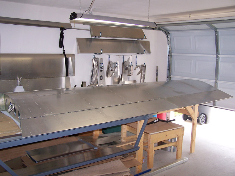

Posted: Sun Apr 15, 2007 1:24 pm Post subject: Re: Dave's brake |
When I need it out of the way, I just take the top plate off, leaving the rest of the brake attached to the table. I was able to build a wing on my table with the brake still in place. I didn't have room for a separate table.

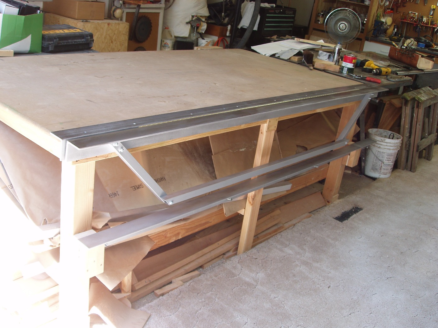

I find little or no interference at all. See attachment for an easy rack for the top piece.
Gary Boothe
Cool, CA
