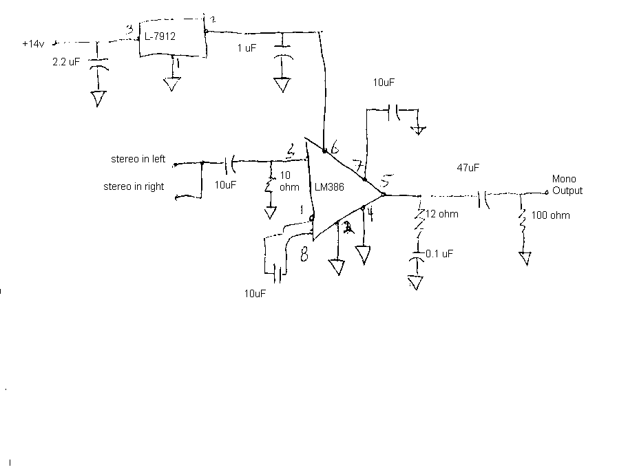

I had the same problem many others did connecting a music input to my flightcom 403mc. The music was so soft at top volume I could barely hear it on the ground and not at all in flight. Turns out in order to save $ there is apparently no pre-amp in this intercom. So if you want to hook up an mp3 player or walkman or whatever you need to supply your own pre-amp. I looked at all the options and decided to try to build my own. I looked at a lot of circuits and borrowed heavily from some like Bob N. I had problems with bobs circuit when coverting from a stereo input to a mono output. It appears that on his amp design where one leg of the stereo input goes to the + input on the op amp and the other leg of the stereo input to the - input on the op amp. So when you hook it up it seems some of the music cancels out any you get some really funky sounds. Very cool, but no music. Maybe I did it wrong, after all Bob is the expert but it certainly looked like bobs design on the breadboard. After lots of testing however I made changes to any existing designs to get the volume to a reasonable level in the headset with the volume control turned to a medium level on my mp3 player. My set-up is simple the mp3 player headphone jack simply goes into the aux music input jack which goes thru this little amp and then to the intercom. Anyway, I'm not an electrical engineer (I'm mechanical) so I am really not all that great at designing circuits, but this one works for me. I thought I would post it in case anybody want to use it as a starting point for their own amp.
http://www.geocities.com/bryanflood2001/AudioAmpfor403MC.bmp
Bryan
certainly looked like bobs design on the breadboar!
Hmmmm . . . stupid mistake. I'm mystified as to how that
happened because I have two other versions of the board
that are wired correctly. I've have a version
9009-300-2A which IS wired with the correct polarity but
also adds spaces for R98 and R99 load resistors cited
in Note 8 on the drawing. I'll get these ordered tonight.
The flipped polarity for stereo-inputs blew right past
me on the earlier version.
Can't argue with success! If folks are interested
in more detail on the LM386 audio amplifier chip
the data sheet can be downloaded from . . .
http://cache.national.com/ds/LM/LM386.pdf
In the mean time, if anyone is interested building
the isolation amplifier and doesn't mind doing a bit
of chop-n-tack to fix the layout error, watch for
the 9009-300-1 boards to go on sale for $10 each
when I add the newer 9009-300-2A versions at the
regular price.
Thanks for the heads-up on this Bryan.
( IF one aspires to be "world class", )
( what ever you do must be exercised )
( EVERY day . . . )
( R. L. Nuckolls III )
nuckollsr(at)cox.net
PostPosted: Fri Apr 06, 2007 4:12 am    Post subject: aux music input quiet on flightcom 403mc Reply with quote
You might want to consider a couple of resistors in
series with each of the stereo outputs before you
bring them together as a monophonic mix. Output
signals from the two channels are not identical
and some degradation of audio will occur when the
outputs "load" each other as described in the chapter
on audio systems. Something on the order of 47 ohms
per side is suggested.

PostPosted: Fri Apr 06, 2007 7:03 am    Post subject: aux music input quiet on flightcom 403mc Reply with quote
A couple of comments if I may. First I have to agree with Bob,
directly connecting two outputs to one another is not a good idea, at
all, and can cause damage to the output circuit of the source device.
47 ohms would work, but at a minimum use a value equal to the
impedance (resistance) of the earphone/speaker normally connected; say
10 ohms minimum. Also, the 10 ohm 10uF combination will limit low
frequencies below ~1600Hz; Ok if you don't want much low end, but...
Attached is a pdf you may want to try. Keep the rest as you had it if
it seems to work well. This one will sum (mix) the L & R signals
without nuking the mp3 player's output, should give you cleaner audio
as well. If you don't like the 10/100 ohm pair, go to 100/1k instead.
Also with this combination the LF will be extended down to about
160Hz.
Ron Q.
old audio engineer.
> <snai> Anyway, I'm not
summing_amp.pdf
Download
 Filename:  summing_amp.pdf
 Filesize:  259.41 KB
 Downloaded:  811 Time(s)

Bob and Ron, thanks for the advice, it looks like I may need to do yet another mod... for some reason I am having trouble with the .pdf file from Ron. Could you send it to me directly at bryanflood(at)hotmail.com? I would really appreciate it.
Thanks again,

WOOPS, I foud the drawing from Ron. Just needed to read a bit further.
Sorry,
Bryan

I had this same problem with my intercom. The basic problem is that the
MP3 player has headphone outputs that are low impedance. That is to say
low voltage but high current output. The intercom input is high
impedance and wants a little higher voltage. I fixed the problem by
making a little box with 2 Radio Shack speaker to line transformers in
it (one for left and one for right) and a pair of 1/8" stereo jacks. If
I remember correctly the transformers were like 8 ohms on one side and
2000 ohms on the other side. That effectively gives a 1:250 increase in
volume level to the intercom.
I ruined an MP3 player running it at 100% volume and it still wasn't
loud enough before I built this box. Now I never run above half volume.
The best thing is that the transformer box doesn't need batteries and
the battery in the MP3 player lasts a lot longer because it's not
working so hard.
I think if you need a mono output to your intercom, you could either mix
the high impedance outputs of the transformers with a couple of 1K
resistors or mix the inputs with a couple of 10 ohm resistors and then
take that and put it through a single transformer.
- Bill

rjquillin(at)gmail.com
PostPosted: Tue Apr 10, 2007 8:07 am    Post subject: aux music input quiet on flightcom 403mc Reply with quote
mix the high impedance outputs of the transformers with a couple of
1K resistors or mix the inputs with a couple of 10 ohm resistors and
then take that and put it through a single transformer.
- Bill
Transformers are an excellent solution to do some impedance matching
and increase the signal voltage available to the intercom and break a
possible grounding problem between the source device, if powered by
ships' power, that at times causes unwanted noise in audio systems,
however a few words of caution and some thoughts.
For reference, from the 603mc IM the aux input Z is 620 ohms, let's
call it 600 and keep it simple.
While the transformer will break any DC connection, an AC connection
remains, and source and load resistances (impedances) from the input
to output, or vice versa, are still a function of the turns
ratio. Simply put, given a transformer with a 1:1 TURNS ratio
connected to a 600 ohm output load, what ever it is connected to the
input will see that 600 ohm load; 10k on the load, the input sees
10k. It's called a reflected load. The voltage and impedance ratios
are only the same with a 1:1 transformer. While the voltage change
is equal to the turns ratio, the impedance difference is the square
of the turns ratio, or the turns ratio is the square-root of the
impedance ratio if that's what you have to work with.
For that 8 ohm to 2000 ohm the Z ratio is 250, or 1:250, but the
turns ratio is just 1:15.8; assuming an ideal transformer. I'll call
it 1:16 for a real world value. Still a good increase in voltage,
but we still have to consider reflected load impedance. That 2000
ohm secondary is loaded by a 600 ohm input. Divide that load
resistance by 250, the Z ratio, and the device driving the
transformer sees a very low 2.4 ohms.
That mp3 player would likely be most unhappy.
On to your solutions proposed above. Hopefully I've correctly
understood what you were saying and put it to paper. Only two sheets
this time. Apologies for that entire data sheet before, that was
not my intent at all !
Sheet one shows what happens with the first solution. Load Z should
be fine at ~42 ohms, but the actual output voltage to the aux input
from a single channel is only 90% of what the mp3 player puts out due
to the loss in the resistive combining network. The actual output
would add L & R algebraically, but would not double unless both
channels had exactly the same program material, a mono source.
Sheet two is what I think is your second suggestion. Here the load Z
an mp3 output channel would 'see' is ~12.4 ohms. Depending on the
device that may be just fine if still a tad low. The overall voltage
'gain' is again the product of the transformer gain, the turns ratio,
16, and the loss from the 10 ohm input resistors looking into that
2.4 ohm reflected load; only 19% of the signal gets through. So the
overall voltage gain, from the output of the mp3 to the aux input of
the 403 is a bit over 3. That's good, but likely not really enough.
For both of these examples we have the generalized case of the
voltage 'gain' of the transformer turns ratio (~16) times the 'loss'
of the [resistor - transformer] combining network ( 0.0566 or 0.1935)
working into the 600 ohm input load of the 403. Were the input-Z of
the 603 higher some additional voltage gain from the transformer
would be easier to achieve, but then other issues of mixing outputs
crop back in.
The active summing amplifier solution, for practical purposes,
eliminates any of those problems since the inverting input of the
op-amp is essentially at ground and neither output channel sees or
interacts with the other. One down side is the inversion of absolute
signal polarity for both left and right channels. Using a
combination of both two transformers and the active summing both the
inversion could be corrected, the mp3 output could be de-loaded a bit
more to keep it happier, and you would have the gain of the amp as
well. Use circuit one and take the junction of the two 10k resistors
to the inverting input pin #2. The mp3 now sees a very nice 40 ohm
load, there is no channel to channel output loading or crosstalk
problems. Don't skimp on the transformer, use something good for a
couple hundred mW.
There just isn't a really good inexpensive passive solution for
mixing two signal sources (L & R) and getting a good amount voltage
gain at the same time, at least not that immediately comes to mind,
what I have left that is.
Ron Q.
