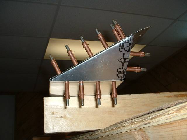

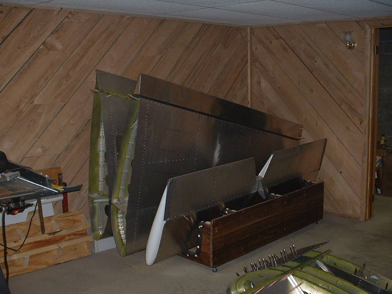

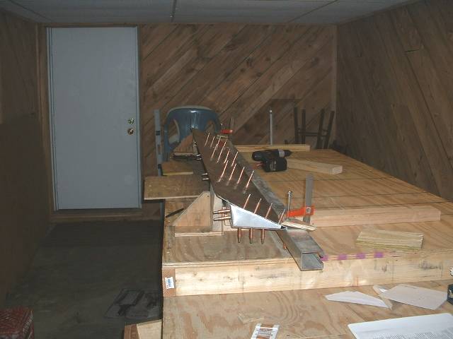

Pictures attached. Hope they help. Talk about old- they're from 1
workshop and 2 cordless drills ago! Hang in there...

Thanks Bill. The pictures definitely help. I'd still like to see a
close-up of the I/B section right where the aileron and the rear zee end if
someone has one though. Some other thoughts:
"Clearance between the aileron and rear zee?"
What I really meant was where does the inboard end of the aileron line up
with the inboard end of the wing. From your pictures, it looks like it is
right at the I/B end of the rear zee at the point where the splice plate
forms the base of the triangle. That is what I thought. I see now also
from the plans you trim the splice plate for clearance in a later step.

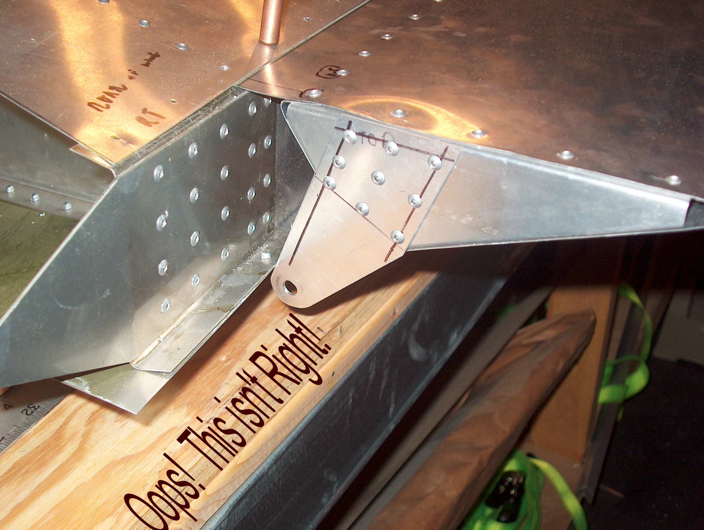

Just to complete the picture, here's a shot of my goof. Hopefully, others
will learn from it. Read the plans 100 times then look for a photo! As a
reference, the O/B end is already cut and fits perfectly.
Thanks everyone for your help and responses. If you have a photo that
matches this shot, but the "right" way I would appreciate a copy.
Mitch
