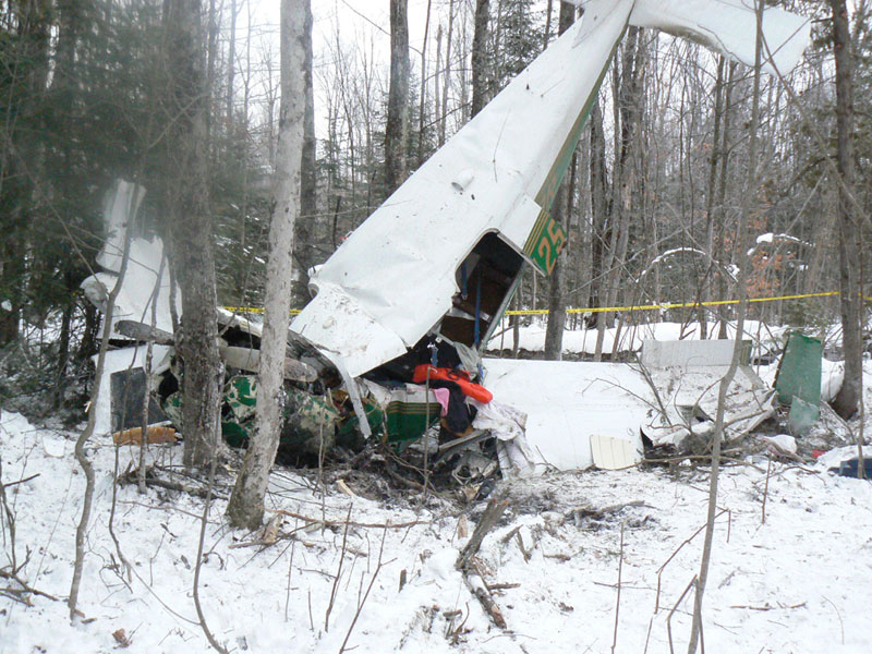

If the wings separate from the aircraft the only risk of fire comes from the fuel remaining in the lines within the fuselage Smile In my years chasing missing airplanes for the CAP the only accidents I remember where there was a post crash fire were ones where the occupants did not survive the impact. If you can maintain control of your aircraft until control is taken away from you there is a good chance that you will survive. Shedding wings and other pieces during a forced landing in rough terrain can actually help reduce the crash forces. Shutting off fuel and electrics prior to impact can help as well.
I've attached a pix of a cherokee six that crashed recently in northern Michigan. All survived albeit with injuries. The pilot put it into the woods after the engine lost power.... he used his cell phone to direct rescuers to his location.
Fly safe!
Tim
Cherokee six crash in N. Mich

PostPosted: Wed Apr 04, 2007 10:43 am    Post subject: Re: Remote Fuel Cut Off Reply with quote
How the hell did they survive that?

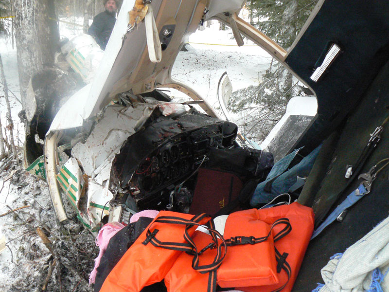

They clipped the treetops on the way in which slowed them down a bit. The engine separated from the fuselage although it rests only a few feet away from it. The left side of the aircraft was opened up with the jaws of life so it was more intact when it came to rest. What's really incredible is the condition of the cockpit (see attachment.) There were 4 souls on board and they waited about 3 hours for rescue.
Tim
BTW - I'm not trying to offend anyone with this discussion or photos. I was involved with search and rescue for 25 years and have been an instructor for almost as long. I try to learn from such tragedies and share the lessons in the hope that others may be spared a similar fate. Personally, I've had more close calls on the highway than in the air.

Ugh! How many broken limbs, particularly legs? That sounds ugly.
Good thing it didn't burst into flames. Bad enough you're stuck in there, worse you're stuck in there on fire.
People freak out over stuff like this, but it could just as easily happen in a car, maybe not the crashing through the treetops part, but being stuck in a burning car.
