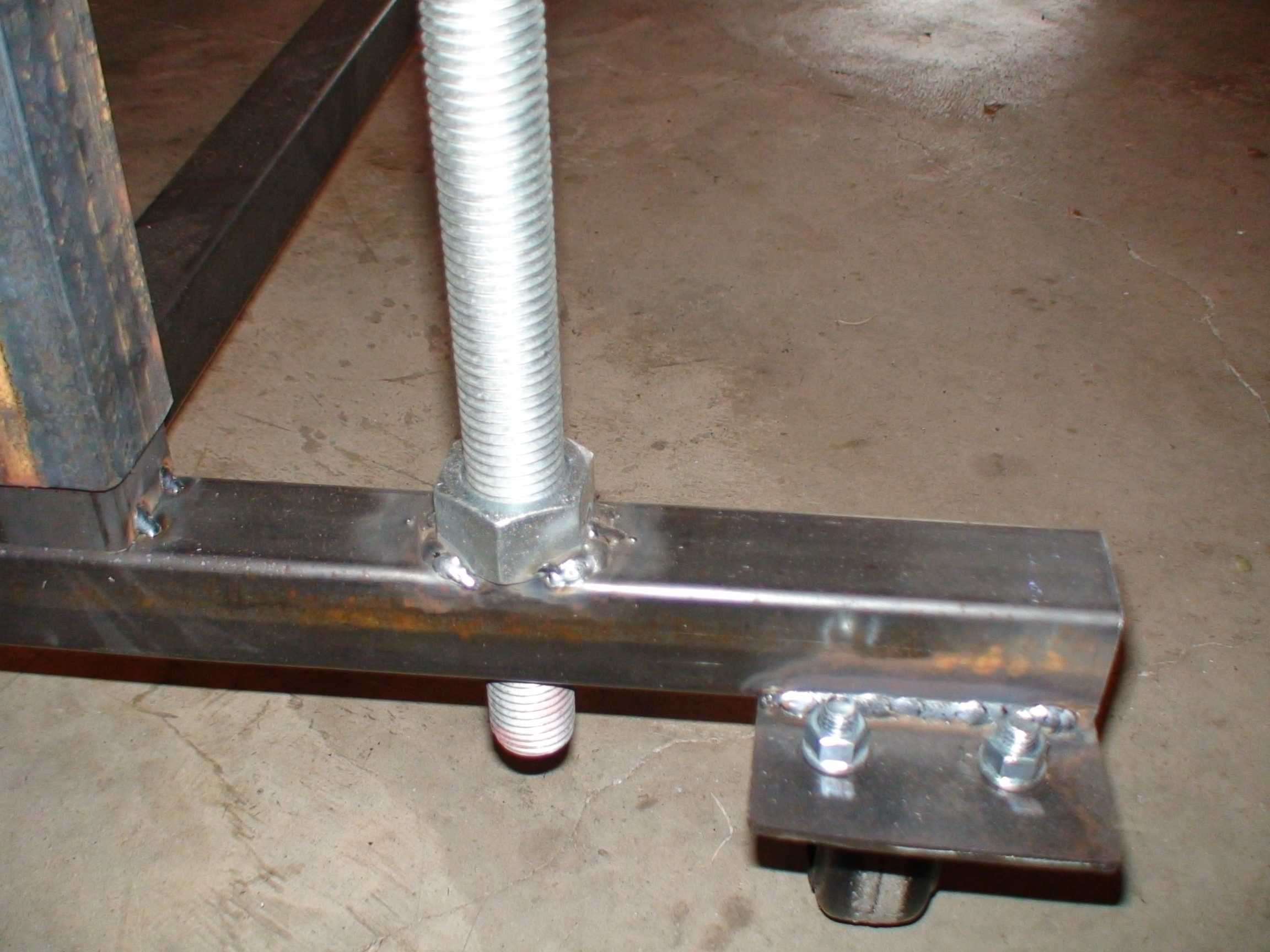

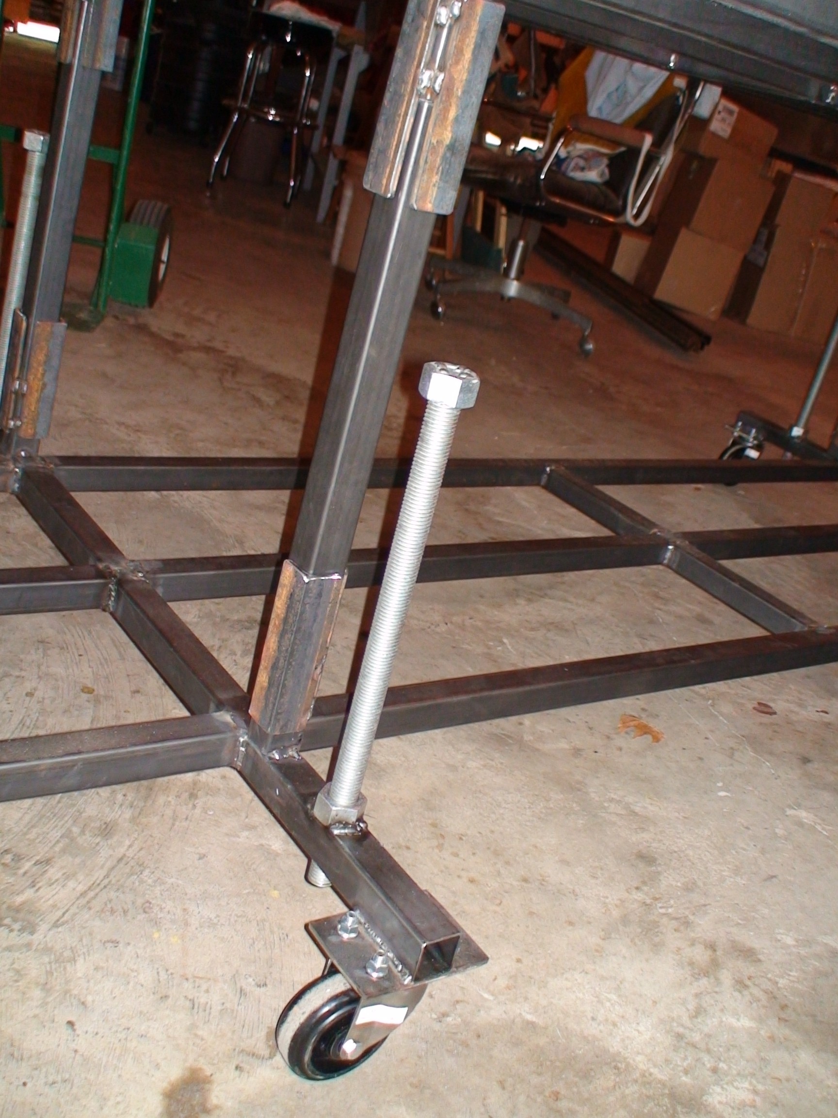

Closeup of the castor and Jackstand
 Filesize:  1.29 MB
 Viewed:  422 Time(s)
A closeup of the sockets, verticals, Jackstands and wheels. The jacks are for leveling and getting the wheels off the ground.

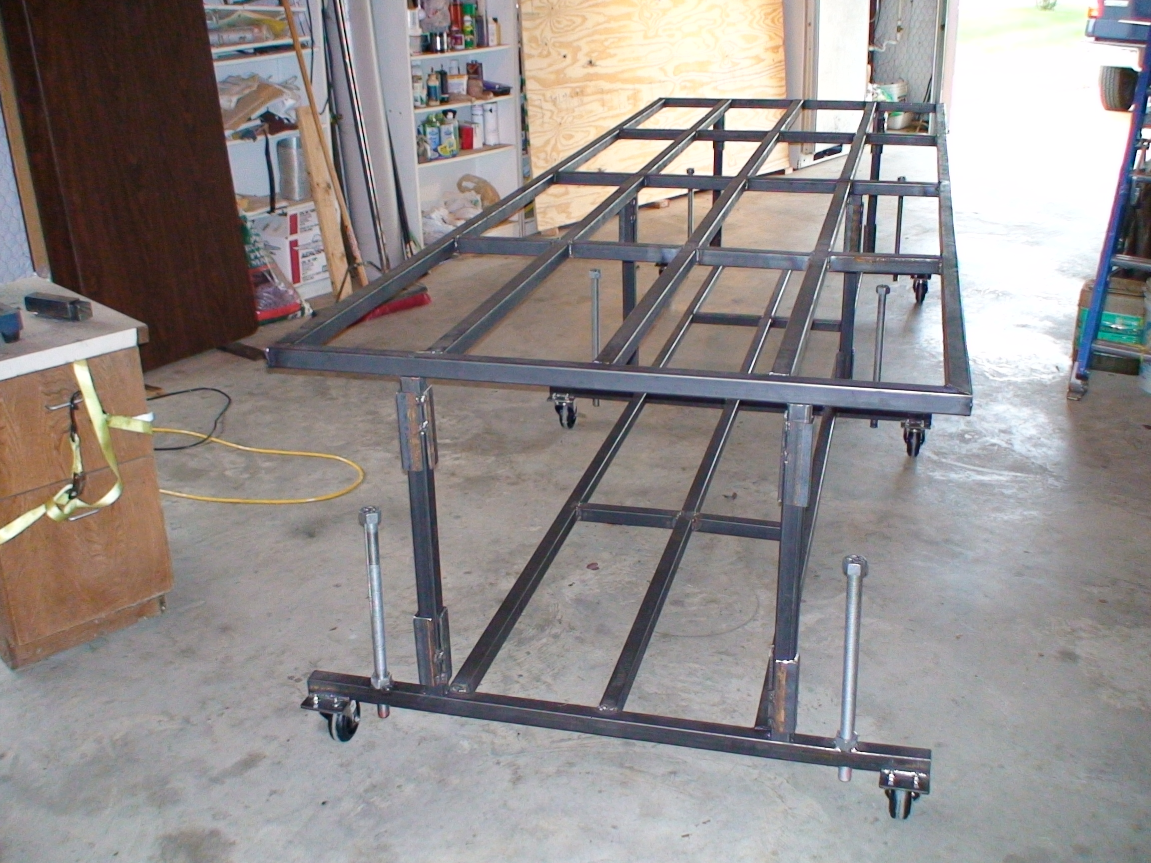

The assembled build table. The jackstands are 1 in all-thread.
 Filesize:  1.47 MB
 Viewed:  503 Time(s)

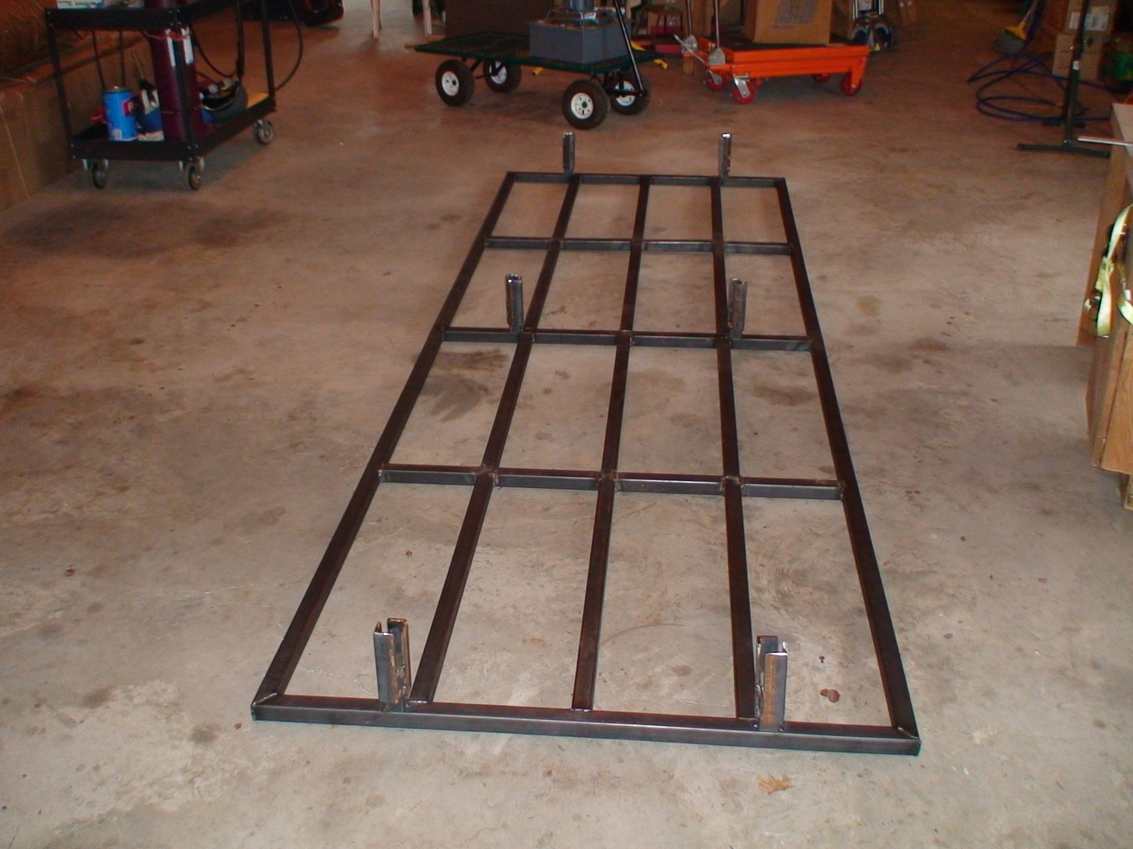

This is the top, upside down, showing the upper sockets.
 Filesize:  1.32 MB
 Viewed:  435 Time(s)

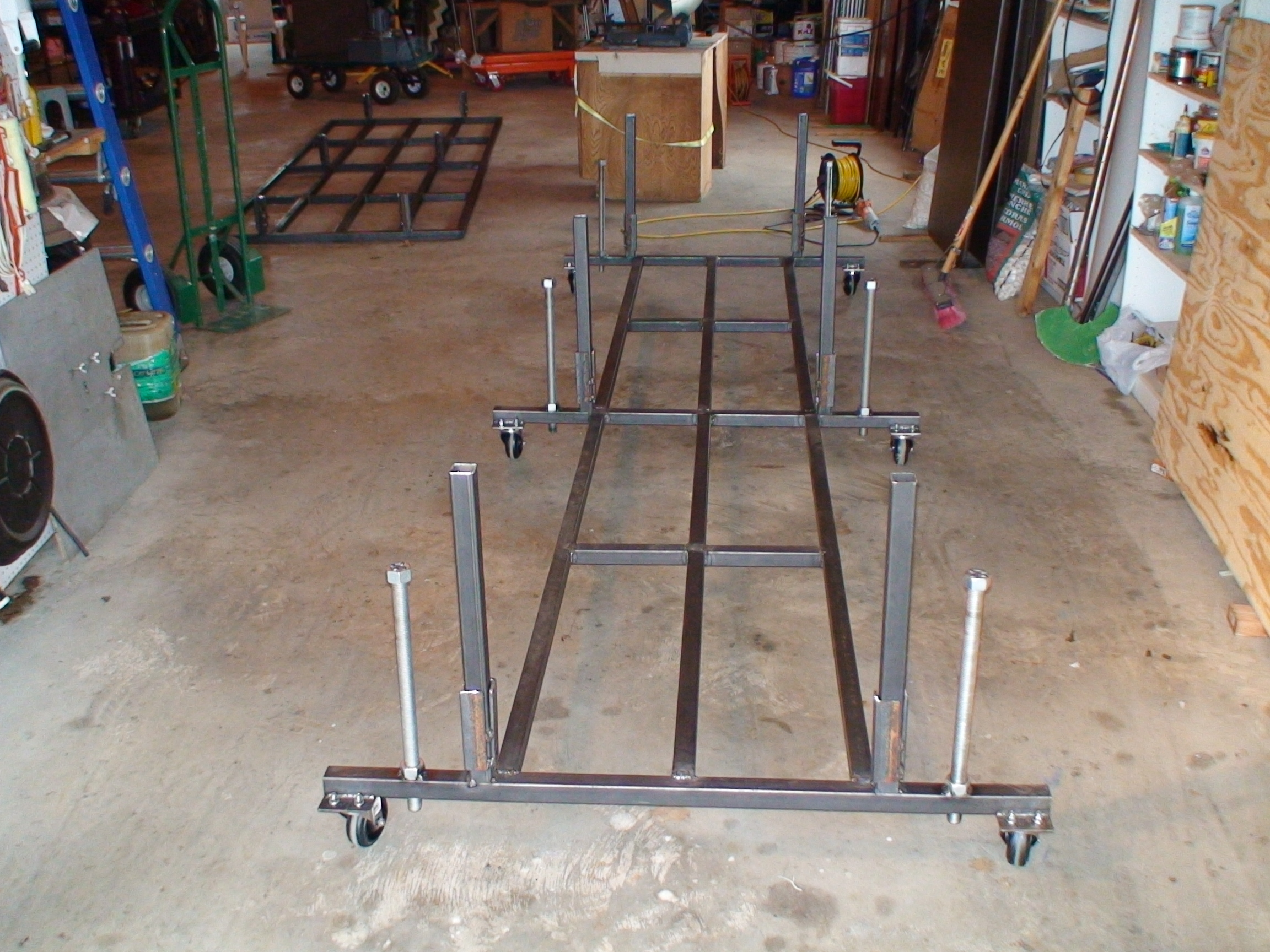

This is the base with the verticals for a 36 in height
 Filesize:  1.45 MB
 Viewed:  428 Time(s)
