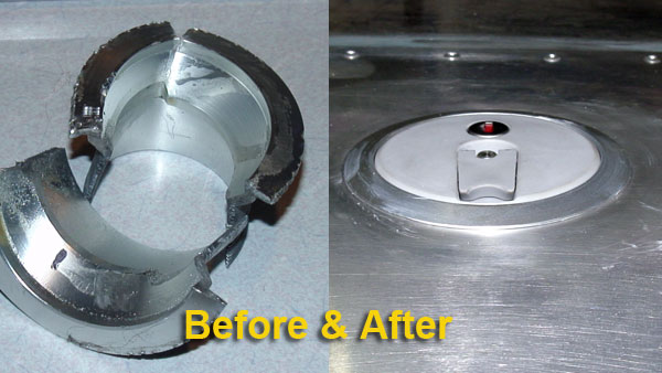

I'm posting this in the hope that others may be spared the problem that I faced with my fuel tank filler. About two months ago I installed capacitance type fuel level sensors in my 15 gallon ZAC made tanks. Deciding it would be a good idea to test for leaks I put about 5 gallons of fuel in each one, screwed the filler neck in by hand, installed the cap and set them aside for a couple of weeks. There were no leaks and after I drained the fuel out I went to remove the filler neck. The left tank came apart ok but the neck in the right one moved about half a turn and stuck. I and an A & P mechanic friend tried everything we could think of but in the end had to carefully cut the filler neck out. It was almost like the threads had welded together, even though I had used oil on them before installing. For what it was worth, I had noticed a couple of spots that turned a little harder when I screwed it in.
I contacted ZAC and they informed me that they would put me on the list to borrow the "big tap" to clean the tank flange's threads out. It was a few weeks before it was my turn but when it came this week I used it successfully to clean up the threads in both tanks. When finished, the new neck (almost a $70 part) screwed in and out very easily.
Today I installed it using a thread sealant and it when on very nicely. I would recommend to anyone that if your filler does not turn in easily that you may want to clean up the threads before trying to install. I've heard of other builders that have had similar problems of freezing threads and it can be costly in time and money to repair.

Filler neck after removal - new filler successfully installed!
