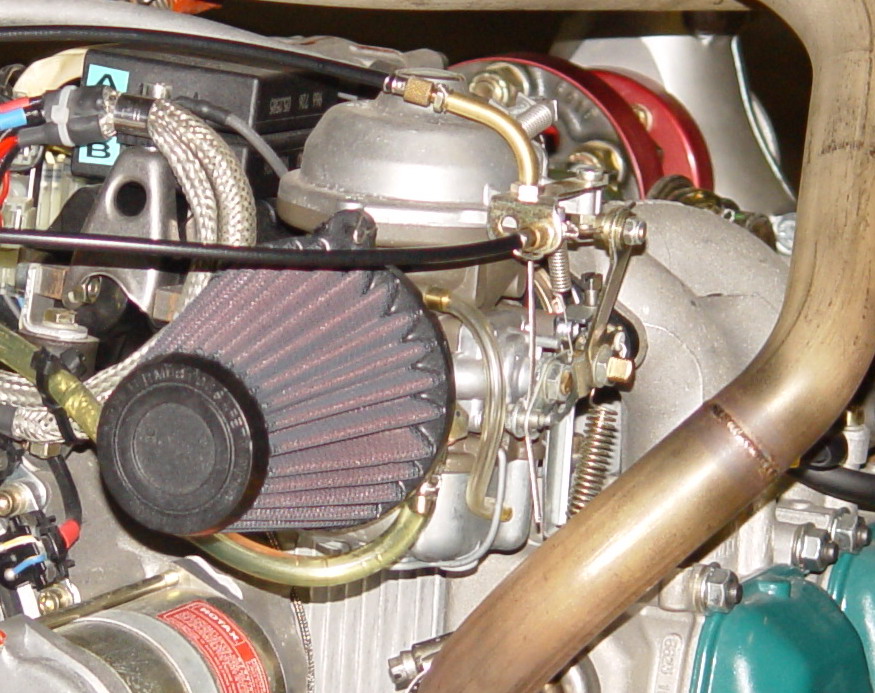

JetPilot
Posts: 1246
PostPosted: Wed Mar 28, 2007 5:30 pm    Post subject: Re: Looking for 912 fuel return line alternatives Reply with quote
Very intresting way to get rid of the air bubbles... I see them in my line, not a lot, dont know if I really need to get rid of them or not. The down side is, the more lines and connections, the more risk of a leak. Im not sure if it would be worth it or not.
With your carb overflow lines, you dont have enough pressure differental to cause yourself a problem, thats good ! That warning is more for those that might be wanting to do the same thing, its bitten people before. Mine wont go onto the exhaust, but it will go onto the hot engine Sad But my engine is not enclosed, so its not quite so bad. You can see a picture of it here
