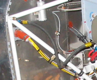

I used 1" stainless steel firewall penetration seals. I only had to file the hole slightly larger than I was originally planning to allow the connector to pass through. Pictures attached.
-Jim

Very nice Jim, you should name your supplier.

I purchased the SS penetration seals and SS heater control valves from:
http://www.epm-avcorp.com/tubeseal.html
