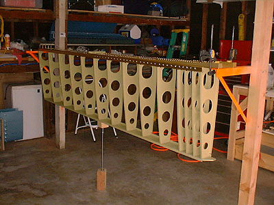

Guys, I'm stumped!
My when I set my leading edges on the spar, the leading edge skin butts right
up to the main wing skins (both top and bottom) perfectly. With the tanks,
it's a different story. I've been trying to figure out what's causing the
gap and the only thing I can come up with is that the Z-brackets are a little
too high.
If y'all have a couple minutes and would be willing to look at what I've
tried, I'd sure appreciate any feedback how to fix it. At this time, the
only solution I can think of is to put a joggle in the web of the Z-brackets
which will effectively shorten them by .040 inch. That seems like it'll be
pretty difficult, though so I'm really hoping for a better solution.
Here's some pics that document the problem:
http://www.our7a.com/20070315.html
http://www.our7a.com/20070317.html
Mike Cencula
ceengland(at)bellsouth.ne

Have you tried pulling the tank down (back) on the spar with ratcheting
strap clamps? (You'll need a spacer at the rear spar to keep from
bending the trailing edge skin.) Run the straps directly over ribs; I
think I put them one bay in from each end of the tank.
With the ribs, it's easy for slight flange irregularities to add up &
push the back baffle back.
Have you checked to see if the back baffle is totally flat (not bowed to
the rear) when it's assembled to the ribs & skin? If it's not, that
would be another indicator that the flanges are pushing the baffle back.
Charlie

Charlie,
Thanks for the response. Indeed I have tried pulling it down with ratcheting
strap clamps. I can close the gap up by doing that, but doing so flexes the
baffle. Is it normal to need to pull the tank towards the spar before
driving the screws into the platenuts?
With no clamps on, the baffle is mostly straight, but the center is bowed *up*
a little. I believe that bowing is because the weight of the tank is resting
on the Z bracket.
Mike

Are the tank holes/spar holes offset by the same amount as the skin gap?
(I've 'over-prepped' an edge or two & that could leave a gap at the
point in question.)
Is the gap between the tank skin & wing skin perfectly consistent along
the entire length & on both top & bottom of the wing? If not:
Is the spar perfectly straight? (Jack under middle of trailing edge spar
& tweak it up/down to see if the tank will fall into place with a little
help from the straps.)
Is there any twist in the spar?
If you haven't riveted on the outboard leading edge, have you tried the
tank without the outboard leading edge in place?

I dunno what the heck happened, but my wing jig was completely out of kilter.
The wing wasn't level and it wasn't straight either. I had a post under the
center of the rear spar to support it, but that wasn't enough to support it
evenly. Instead of one long U shaped bow, I had two smaller ones. I ended
up putting three supports under the rear spar at 25%, 50%, and 75% of the
length. I also redid all the mounting points and re-leveled everything up.
The only thing I can guess is that either the 4x4s I made my jig out of warped
or twisted, or maybe my basement floor shifted some since I put the jig up
last fall. I also discovered that the bubble in my carpenter's level shifts
probably a full 1/32 inch just by flipping it around. Arghhh!
Anyway, spending a couple evenings with a borrowed precision machinist's level
(I'm tempted to throw out that carpenter's level I originally used) got
everything straight, level, plumb again. And now, the skins fit together
PERFECTLY!!!! I'm soooo happy! Smile

dan(at)rvproject.com
PostPosted: Wed Mar 21, 2007 6:04 am    Post subject: Z-bracket height (again) - Help! Reply with quote
The old DWG 12A shows a "jack" supporting the center of the rear spar as the
wing hangs on the stand. It says "REMOVE SAG FROM WING WITH A JACK OR
EQUIVALENT SUPPORT." Lame!
I really wish Van's didn't even show or mention a JACK on the drawing. To
state the obvious at this point, jacks might leak down and retract over
time, and there goes your perfect alignment. Given how long it takes some
builders to build their wings, you really gotta consider something much more
"fixed" in nature that won't vary over a period of time.
Here's what I did instead:
http://rvimg.com/images/2002/20020715_skeleton_on_jig.jpg
It's a piece of threaded rod with a deep hole drilled into a 4x4 base block.
The rod can slide in and out of the hole in the 4x4. With a nut & washer on
each end of the threaded rod, I could fine tune the support height/pressure.
Once it was "locked in," it wasn't going anywhere.
I definitely recommend doing something like that instead of using a jack.
)_( Dan
RV-7 N714D (1230 hours)
www.rvproject.com / www.weathermeister.com / www.weighmyplane.com
 Filesize:  50.1 KB
 Viewed:  748 Time(s)
matronics(at)cencula.com
PostPosted: Wed Mar 21, 2007 7:44 pm    Post subject: Z-bracket height (again) - Help! Reply with quote
Dan,
That's almost exactly what I did, except I added two more of them at the 25%
and 75% spots. My blocks are 2x2 and have 2" long hex bolts threaded into a
tee nut in the bottom end:
http://www.our7a.com/20070320.html
Mike

Glad it worked for you. I've worked around wood long enough to know that
it's almost never in the same place from one day to the next. I left the
alignment string stretched on my spar even after riveting started. I was
so paranoid I rechecked the level across the spar every time I started a
riveting session on the wing.
BTW, the cheap scissor jacks the come with some foreign cars work great
& are easy to adjust without tools.
Charlie
Michael D. Cencula wrote:
Charlie, you rock!
Thanks, Charlie, and thanks everyone else who took time from their day to look
at the problem and respond.
Best regards,
Mike
