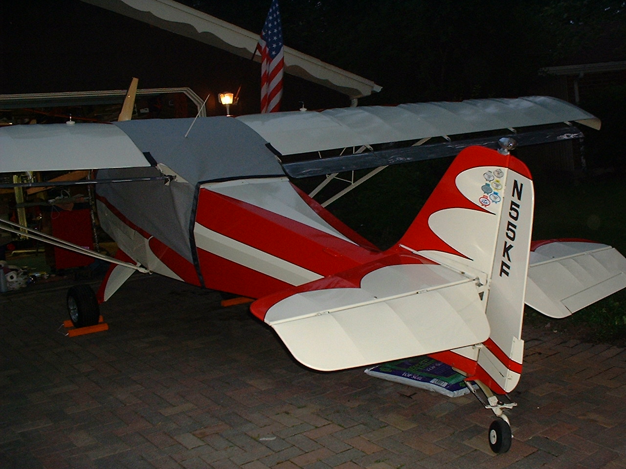

rliebmann(at)comcast.net
PostPosted: Mon Mar 19, 2007 7:09 am    Post subject: flase ribs Reply with quote
Hi Jerry,
The false ribs are not there to provide any lift. If they are of a symetrical design, they will provide stability.
I have them in my fin but not the rudder but they are in my stab & elevator. If you put them in the fin & stab only, I think that that set-up would work fine.
Take Care, Ron N55KF
 Filesize:  302.48 KB
