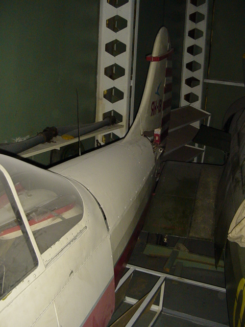

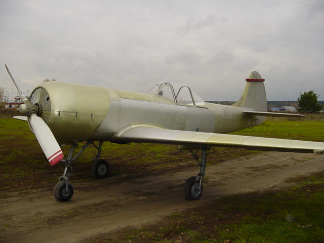

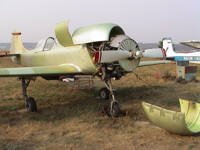

This is how they do it in Russia.
Personally I use a 1inch nylon luggage strap with non slip catch from the
left rudder pedal to the frame just aft of the front seat at shoulder
height.
kp

PostPosted: Fri Mar 16, 2007 9:24 am    Post subject: Yak-52 Rudder Lock Reply with quote
Actually I think the hoop in both pictures is an elevator one whereas the
correct rudder one drops lower over the fin.

Hi,
Can anyone tell me what the aircraft in the pictures is. It looks like a Yak
50 but not tail wheel.
Lance Robb
NQ Warbirds
Australia

pilko2(at)btinternet.com
PostPosted: Sat Mar 17, 2007 1:35 am    Post subject: Yak-52 Rudder Lock Reply with quote
It's a so called "53"................ in reality a 52 with the front cockpit
removed. and panelled over. The picture was taken in Russia
but I believe the aircraft now fly's in the US.
