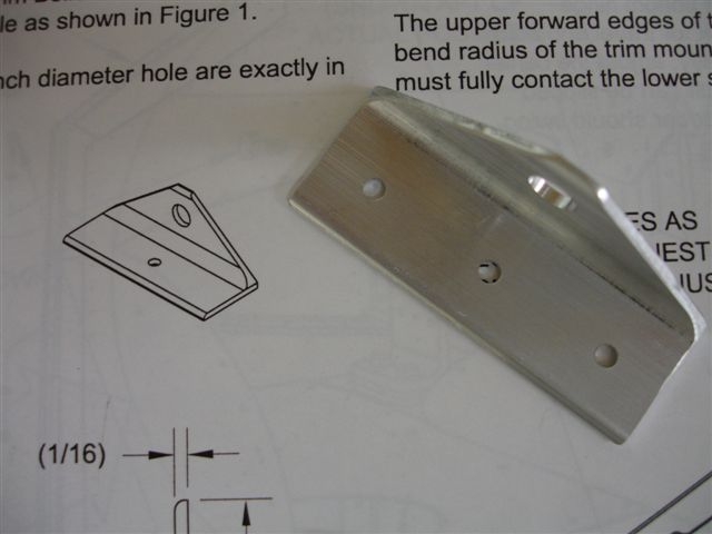

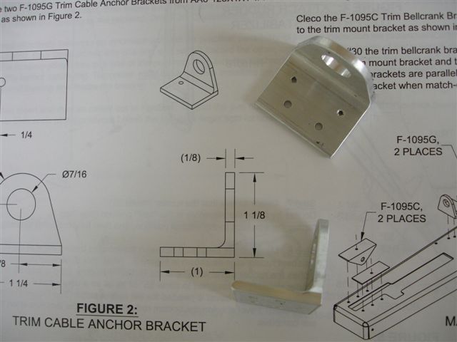

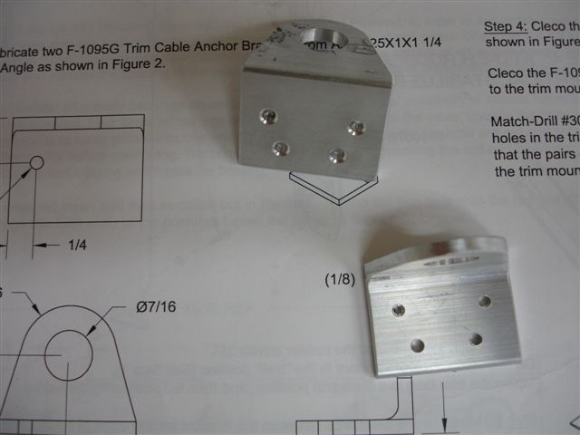

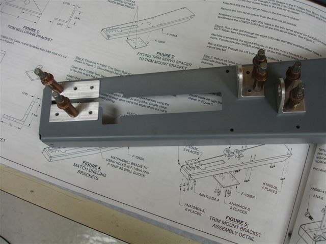

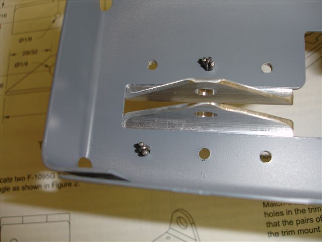

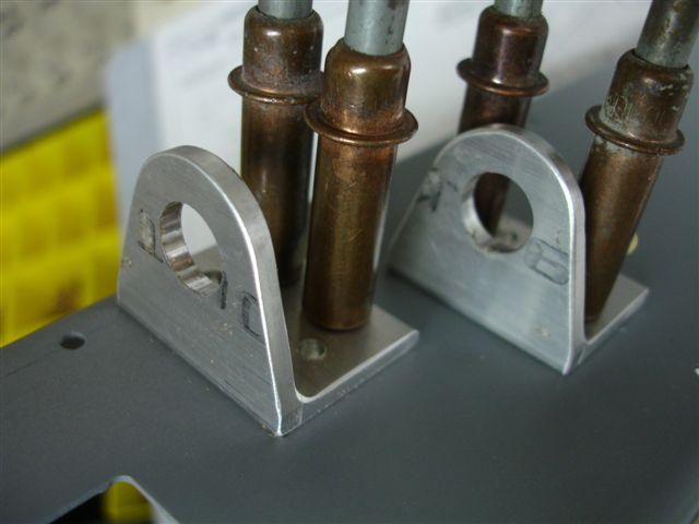

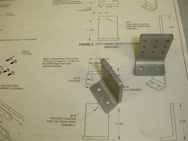

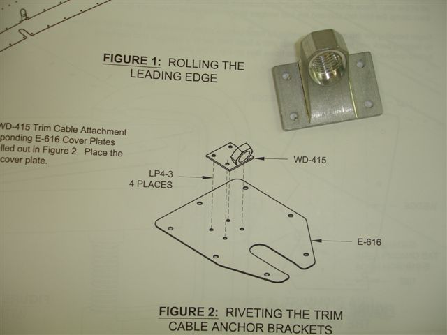

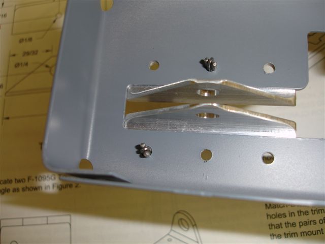

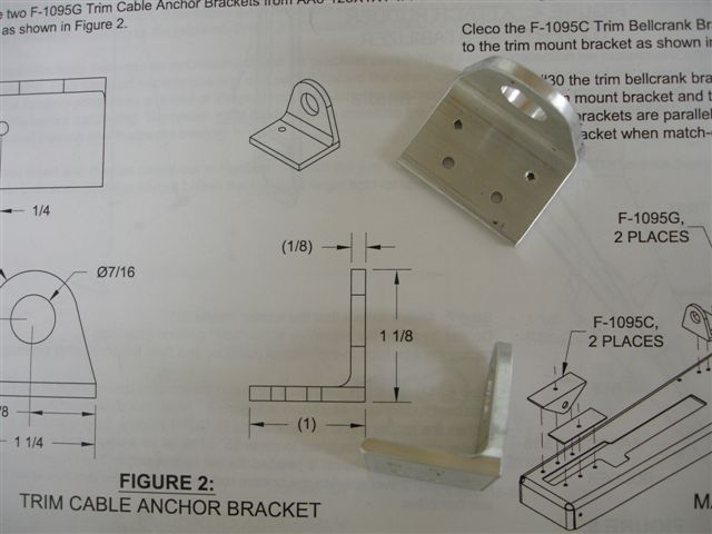

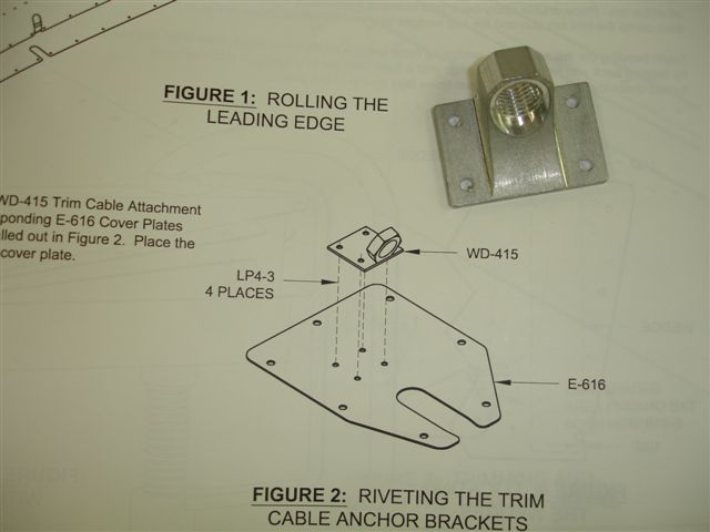

Jeff and fellow RV10 builders. Yes, Dave is still making these parts. If fact, he did a few more (see photos below). Dave is trying to put together an "RV10 Tail Kit". This kit will have many of the harder to make parts such as brackets, spacers and such. As I work on my tail kit, I ask Dave to make a part. He programs it on Solid Works and goes to town on the CNC.
Dave is hoping to put the following items in this RV10 Tail Kit Supplement....
Horizontal Stab Attach Brackets (hard to make for the builder so Dave
did it on the CNC with all holes predrilled! This is one bracket that
must be done right because it holds the front spar of the HS Stab to
the fuselage.)
Trim Cable Attach Bracket. The supplied Vans part is a cheap looking
part and binds the trim cable on my plane. Dave has a CNC billet
one that is 3 times stronger with the proper angle.

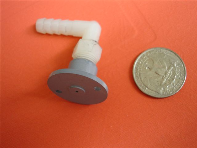

CNC milled static air ports. See photo.
CNC cut brackets for the trim motor bracket and cables.
