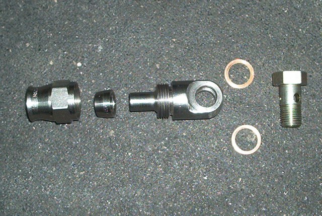

Completed Home grown 10mm to -6 Banjo for Aeroquip 666 Teflon hose with
conductive lining.
The 666 is smaller OD than other -6 hoses and allows me to plumb 914 from
201B Flowscan senders under Airbrake horn, through firewall between
footwell and UCMF.
Made it out of 416 Stainless, replicating Aeroquips reusable fitting
design.
I used Aeroquip Olive and Nut.
Ron Parigoris
