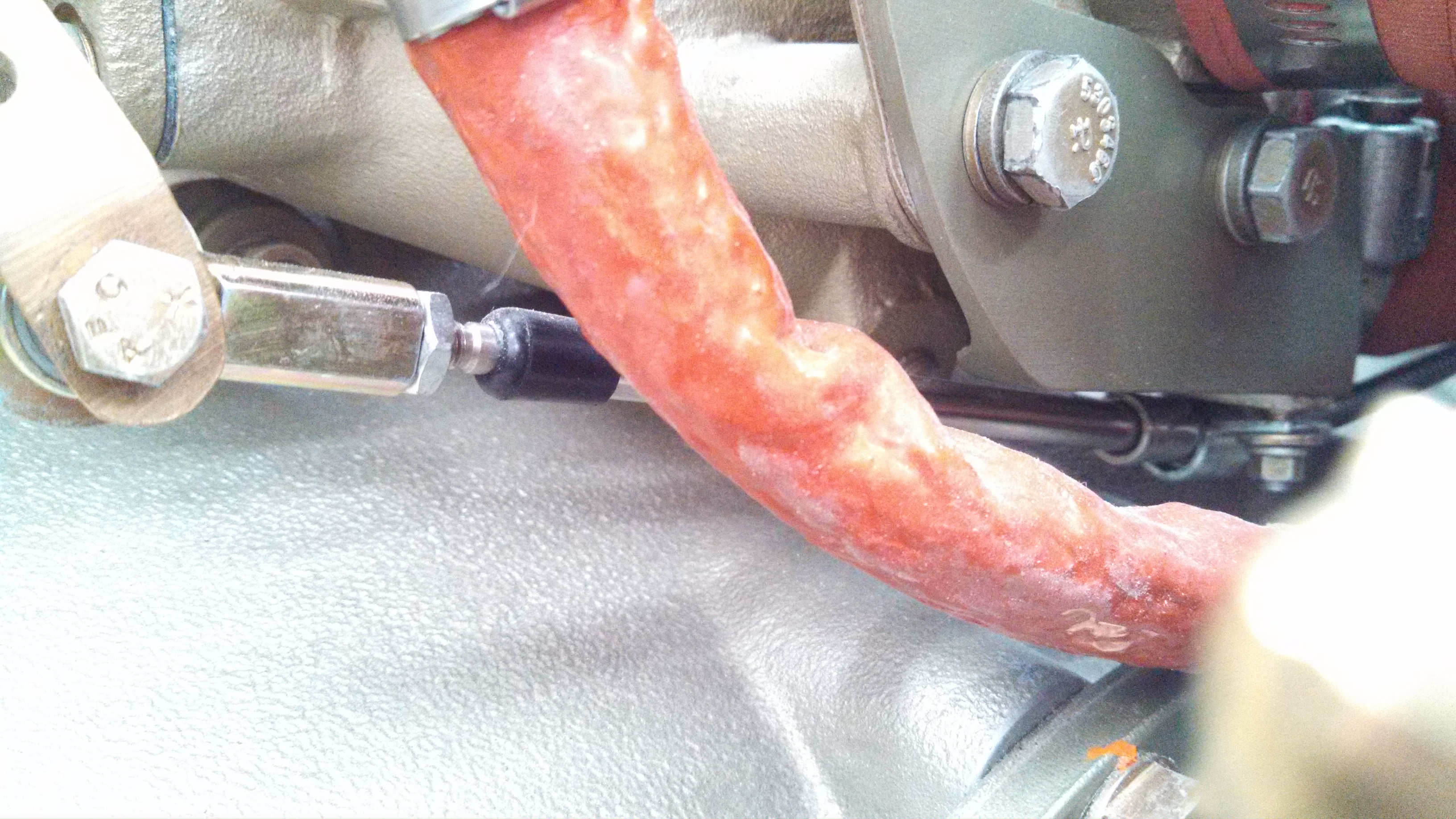

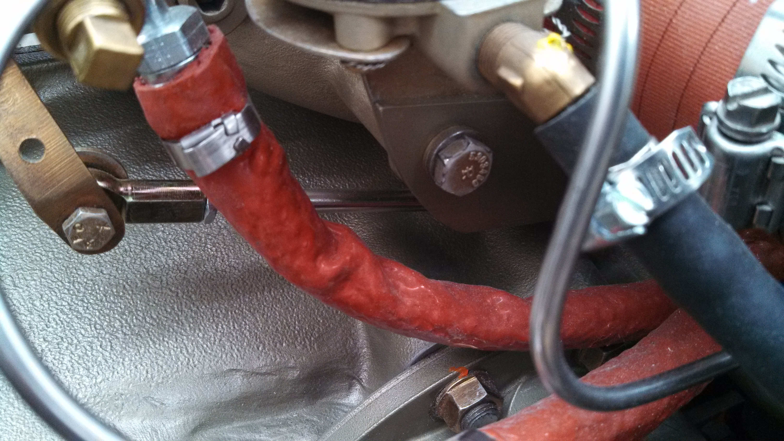

PostPosted: Thu Oct 24, 2013 5:57 am    Post subject: Re: Landing gear warning trigger Reply with quote
Again, a picture of your carb/servo/throttle body and cable attachment would
help shed some light on the problem.
Okay. Here's some pic's. Hopefully they'll help.
 Filesize:  544.54 KB
 Viewed:  11824 Time(s)
 Filesize:  559.98 KB

PostPosted: Thu Oct 24, 2013 7:14 am    Post subject: Landing gear warning trigger Reply with quote
Seems to me that an aluminum bracket and a micro-switch would do the job.
John

berkut13(at)berkut13.com
PostPosted: Thu Oct 24, 2013 7:30 am    Post subject: Landing gear warning trigger Reply with quote
Yep. You already have a fabricated bracket and two anchor bolts available
close by. I'd just re-make the existing bracket (or add a new one) to
extend toward the lever arm and mount a micro switch. You could put an 'L'
shaped tab on the arm using the existing hole to contact the switch if you
need to move the assembly inboard to clear the fuel line.
Or like I mentioned before, mount the switch remotely and activate it with a
slave rod (piano wire) from the lever arm...on either side (push or pull can
work). That's a little more complicated but allows you to work around space
limitations or obstructions if needed.
Simple stuff...bunches of various options. I see no real need for something
complex.
BTW, I hope this you have already addressed this - that mounting clamp looks
not to be fully secured. You don’t want to "pre-disaster" yourself and have
the throttle linkage come loose in flight. Just checking.
-James

donjohnston
Joined: 13 Dec 2009
Posts: 232
PostPosted: Sat Oct 26, 2013 4:50 am    Post subject: Re: Landing gear warning trigger Reply with quote
Nope. That's what is typically done. But the routing of my MAP line doesn't allow for that. I couldn't get a picture showing it, but extending the bracket would require new fittings and a new MAP line to be fabricated. I'm trying to see if there's a workaround.
Or like I mentioned before, mount the switch remotely and activate it with a slave rod (piano wire) from the lever arm...on either side (push or pull can work). That's a little more complicated but allows you to work around space limitations or obstructions if needed.
That's a thought. I'll have to look and see how much trouble that's going to be.
Simple stuff...bunches of various options. I see no real need for something complex.
Agreed. That's why I was thinking of a MAP switch that would close when the MAP got down to around 12-13"
BTW, I hope this you have already addressed this - that mounting clamp looks not to be fully secured. You don’t want to "pre-disaster" yourself and have the throttle linkage come loose in flight. Just checking.
